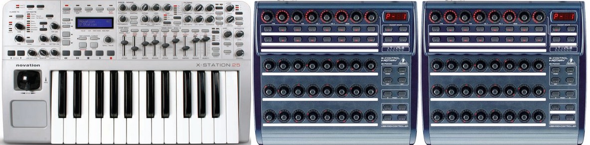

The idea would be to be able to gain midi control capabilities on scope devices using more than the 120 Midi CC messages for each midi channel.
Expansion would be possible through Polyphonic Pressure Messages (as used in the former NOAH unit) and NRPN midi message. This would mean an expansion from 120 to 376 control messages.
The idea would be to allow extensive use of MIDI controller unit like MIDI controller keyboards or MIDI controller (especially in my situation: my novation X-station and couple of Behringer BCR-2000 which offer me : 150 + 110 + 110 = 370 midi control elements).
The additionnal requirement would be a set of SDK DSP modules update providing these features.
Maybe already under way.

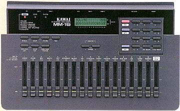

PS: I also have an "old" Kawai MM-16 used for main mixer control (16 channel volume).
- Mixer control additionnal midi controller
- mm16.jpg (24.09 KiB) Viewed 3829 times
- Device control setup:
370 messages available, can be splitted to control 3 devices but would also be fun for a complex one.... - Hurolura control surface.jpg (127.85 KiB) Viewed 3830 times

Hurolura's rig looks like heaven for a DJ.

A bit Off Topic but here are my feeling about the X-station:alfonso wrote:
btw, how is the x-station, quality wise (faders, smoothness, solidity)?
It looks very interesting.
- first contact with the knobs make me think they are a bit too small and too close to each other (I am more used to encoders with knob of the size found on BCR 2000, NOAH/ASB units, Waldorf Synth), but getting used to them, they can do the job. The other trick is that most of them are pot (16) rather than encoders (3 with click feeling though which could be usefull for fine step adjustment)
- the faders are maybe a bit small
- the control surface being organised as a classic synth is smart and easy for synth plug-in control (if I had time enough, I would have build up X-station templates for the NOAH as I did with the BCR 2000, but my plug-in synth project will probably hold me busy a few more months)
- the integrated synth and effect section sounds quite good (almost a A-Station, K-Station here though monotimbral and limited 8 notes polyphony)
- the display is helpfull to see the parameter you are modifying
- the template building software is correct and works good (though not necessary if you accept to "type" the text with the data/value knob - especially when far away from any computer)
- the unit is really compact (with the too close control element drawback as a consequence)
My feeling in general is that X-station is more synth-oriented as BCR 2000 units are more "generic" ones (no surprise here !!!).
