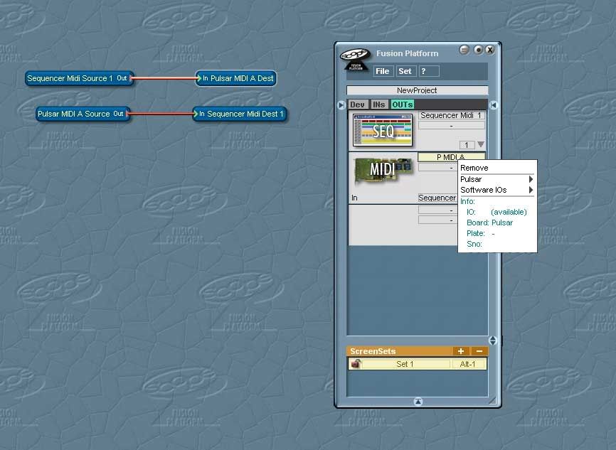

It's done for shure. here is the project:
Seq midi source -> Pulsar Midi A dest
Pulsar Midi A source -> Seq midi dest
Should be fine... It's not a project configuration problem imho.

hmmm, this seems like a manual problem. if the cards are correctly installed, then they MUST work. do you have sequencer midi source and destination modules in the routing window?
Re: No midi out on my pulsar
ok then I've got the midi out in the so called Livebar
a jpg of the project:
http://i163.photobucket.com/albums/t290 ... roject.jpg
wow, so you have midi into the sequencer and out of the sequencer. midi comes in from the cable whip on the card and goes out that way.
that should work. of course you have no audio and the routing is pretty limited, but you should have midi, as long as that project is in place BEFORE you open the sequencer.
the sequencer midi modules represent the physical i/o(the jacks, if you can believe it) of the multitrack recorder that is the sequencer. the pulsar modules represent the hardware connectors on the card(the other ends of the actual wires). asio source/dest modules are the actual jacks for the sequenecer and the wav and 24bit wav modules are i/o for other windows programs. you can use a mixer in there and connect things just like in a real room. also, this imaginary room(the routing window) can interface in realtime with the real world via the hardware i/o(pulsar midi, analog, adat and sp/dif modules).
