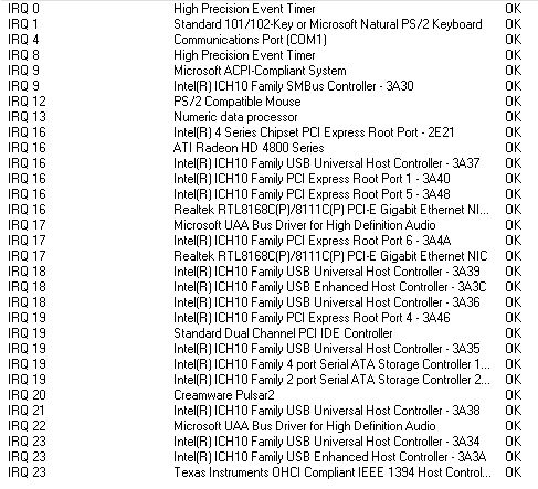

yes, true. is the card sharing an irq with anything else?

Yes i many times did change the Pci slots also on the old pc's ,the irq's was also ok like now,there is not any other share with pulsars.

- i checked the irq's and did it before too, here the results again.
- p.jpg (85.85 KiB) Viewed 1139 times
