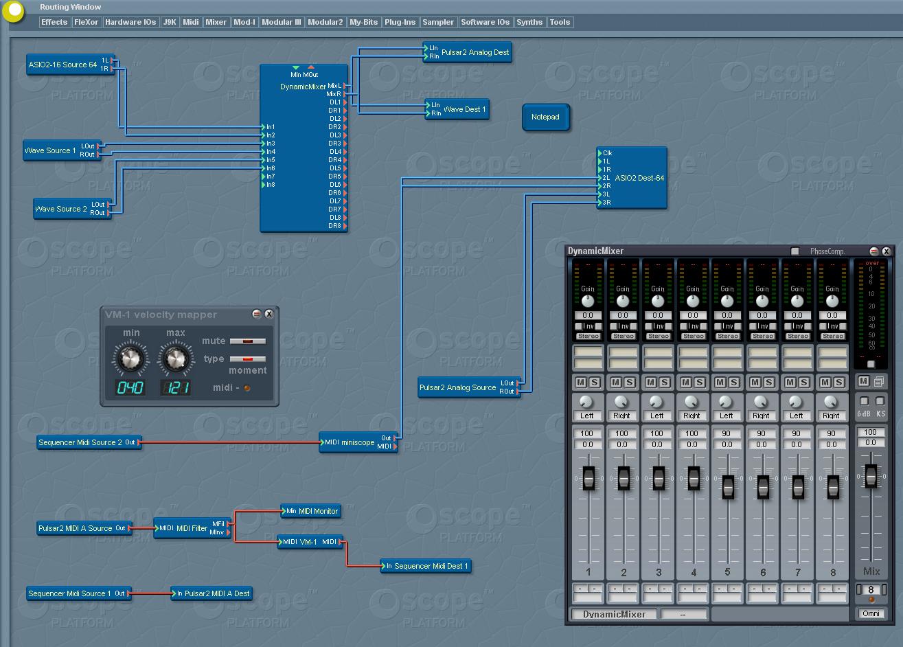

So, I can fix the velocity, say to 80, if that's what sounds best for a patch? If you remember I had a little device put together within Scope to allow me to handle velocity better - this does sound appealing.
I'm simply overwhelmed by your support - THANK YOU - I'll look into all of this in more detail now.

Ah,
the fixed velocity is 100, so I'll still use my handy little velocity slider device in Scope.
They look good don't they for the price, and compared to M-Audio's price list they look VERY good

I'll have a read of the manuals and see if it will fit in with my rig. It's still the USB/Cubase/Scope project thing that's confusing me though.
I got some great deals from tehm last year.
Anyway, I waffle.
Re: Thinking of upgrading my keyboard - help please
The USB/Cubase/Scope thing isn't an issue at all though. The USB keyboard will show up in Cubase as a selectable midi input alongside the other midi inputs just as any USB midi interface will. So you select it as a midi input on a midi track & Creamware midi as the midi output on that track.. done. As ever, you'll also be able to select it simultaneously as the midi input on other tracks & send the midi elsewhere, stacking up instruments etc.

Okay, ta - I'm beginning to understand where you're coming from on this.Shroomz~> wrote:The USB/Cubase/Scope thing isn't an issue at all though. The USB keyboard will show up in Cubase as a selectable midi input alongside the other midi inputs just as any USB midi interface will. So you select it as a midi input on a midi track & Creamware midi as the midi output on that track.. done. As ever, you'll also be able to select it simultaneously as the midi input on other tracks & send the midi elsewhere, stacking up instruments etc.
I've read the M-Audio manuals and also had a look at the Cubase manual re midi inputs.
So, please tolerate my ignorance a bit longer.............
I'm new to Cubase 4 as well, so I just want to clarify a couple of points.

Now, regarding Scope. I attach a jpg of a fairly standad project that I use.
Do I need to add another midi source to the project - oops, just checked - I can't can I?
This is the bit that's confusing me as to how I can be using both keyboard and Freak in this project.
Sorry, I'm in thicko mode this week or venturing into unchartered waters!
Neil
- project2.JPG (170.01 KiB) Viewed 908 times
usb midi doesn't go through scope, except when it comes from the sequencer.
Ah,
thanks Gary - I knew there was something rolling around in the void between my ears.
Damn shame that 'cos I often use the keyboard with just Scope & no Cubase etc.
Back to the drawing board I think for a midi (not USB) keyboard.
Oh and thanks to all for tolerating my ignorance, but then you're all used to it

Yes, It'll be available in any midi input list in Cubase alongside any other available midi inputs & will either be called 'USB Audio Device' if using the standard Windows Class Driver or 'USB ProKeys 88sx In' if using the Windows Multi-Client Driver.Neil B. wrote:Okay. In Cubase then, I select it as a midi input - I understand that.
No, that's not the case. You will have 2 midi outputs available for the ProKeys 88sx. They're named the same as the midi input except they're numbered 1 & 2. No.1 is for sending midi to the internal sounds of the keyboard & No.2 is for sending midi to the keyboards midi output port.Neil B. wrote:Now, the midi output on the 88SX is of no use to me.
That's right. The only other option is if you ever get a 2,4 or 8 ch midi interface, then you could obviously connect the Control Freak via that.Neil B. wrote:I now have to think about the Kenton Control Freak. I aasume that this becomes "stand-alone" with it's midi out to the midi in on the Scope cable whip (basically I disconnect the midi lead from my existing keyboard to the Freak).
Exactly!Neil B. wrote:Note & veocity (and some other data) is therefore transmitted over USB and any CC's I wish to manipulate goes via the Freak.
Well, you could, but I wouldn't recommend doing that unless you literally want all midi data entering cubase to be coming into that channel. It's much better practice to use 2 separate midi tracks in cubase, one for your note data for which you'd select the USB midi input from the keyboard & a separate track for your controller data from the Freak, for which you'll select the Creamware midi input. If you want both tracks to go out to Minimax or something in Scope, then you obviously just select the same midi output for both tracks in Cubase. Doing it this way with 2 separate tracks allows you very quickly to edit like cut, copy & paste sections of either track from the main project window in Cubase without affecting the other. It's a great way to work!Neil B. wrote:In Cubase then, I select for the midi channel "All Midi Inputs" ??
I've explained it above. The USB keyboard & Freak midi data can both come out to the same midi source from Cubase if you want them to be controlling the same device in Scope. You only want to having them coming out to separate sequencer midi sources in Scope if you wish to control separate Scope devices with them, like if you're controlling say a synth with the Keyboard & a different device like a second synth, mixer, effect or whatever with the Control Freak.Neil B. wrote:Do I need to add another midi source to the project - oops, just checked - I can't can I? This is the bit that's confusing me as to how I can be using both keyboard and Freak in this project.
No problem at all. Someone will always be around here that can help.Neil B. wrote:Sorry, I'm in thicko mode this week or venturing into unchartered waters!
