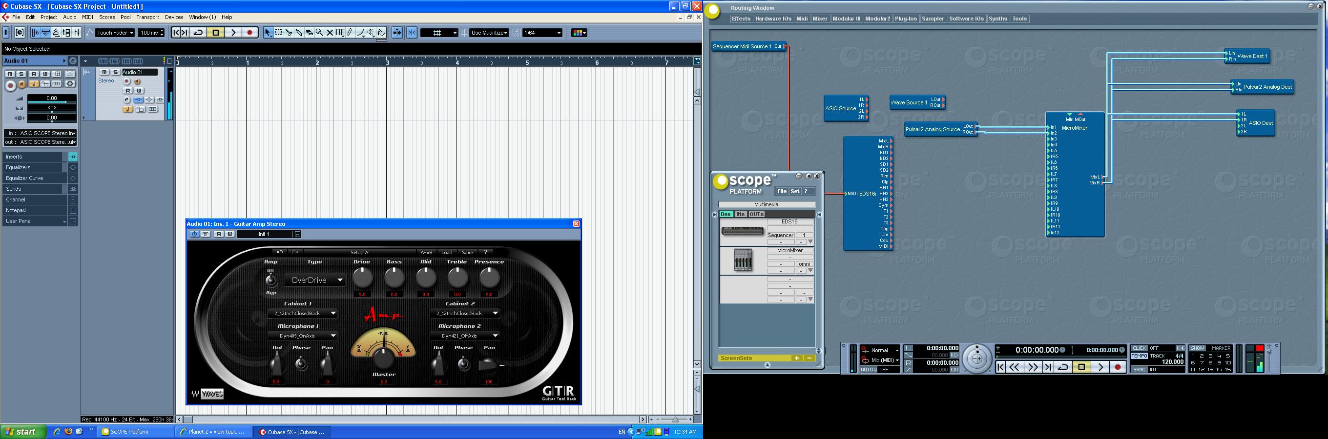

TomerTTB
Posts: 33
Joined: Mon Jan 19, 2009 6:29 am
Re: Connecting an analog device, can't hear the effect.
Post by TomerTTB »
Hi and Thanks for trying to help me
I am attaching a pic of my Project.
I did not understand how I suppose to route the effect in cubase back to ASIO2
It will be great to get more details about that.
As you can see in the pic attached, the efect "Waves" is working but I hear only the original notes of my guitar with out the effect :(.
Tomer.

Me$$iah
Posts: 379
Post by Me$$iah »
run the guitar from analog source direct to ASIO in.
then choose which ASIO channel in cubase, attach this to Analoge dest.
Then the signal goes into cubaes, the effect is added, then it comes out the asio to the monitors.
It wont be real time, there will de the latency introduced by the ASIO drivers
Thats how I do it
Mr Arkadin
Posts: 3283
Post by Mr Arkadin »
Pretty much what Me$$iah said, although i would add a mixer between the ASIO2 Source and the Analog Dest as this allow you to control the level going to your monitoring and also allows you to mix in other ASIO sources which you may need to play along with.

TomerTTB
Posts: 33
Post by TomerTTB »
Thx its working :)!
