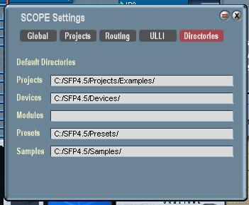

What version of Scope/SFP are you running?
What is the installed path? (ie, C:\Scope\ etc)
Run Scope (SFP) and go into the "Livebrowser" menu, Set>Settings>Directories, do you see any paths there?
Answer the first 2 questions as well please and we can tell you if your Directories settings are correct, and if not what to set them to.

C:\SFP4.5
I made a image for the directories...
I check in the sample directories, there is no wav and no file looking like the vorb wav samples.
Thanks for help !

I made also a .wav file search in the SFP directories, there is no such file.
Re: Orbitone Vorb...
It won't help here, but if you use Mod2 or 3 set the "Modules" line to be: C:/SFP4.5/Modular2 Modules/
As for Vorb, it's quite probably that it's using samples in another format, either .pcm or .s. Try running the oxe again (with Scope running) and close, then restart Scope.
