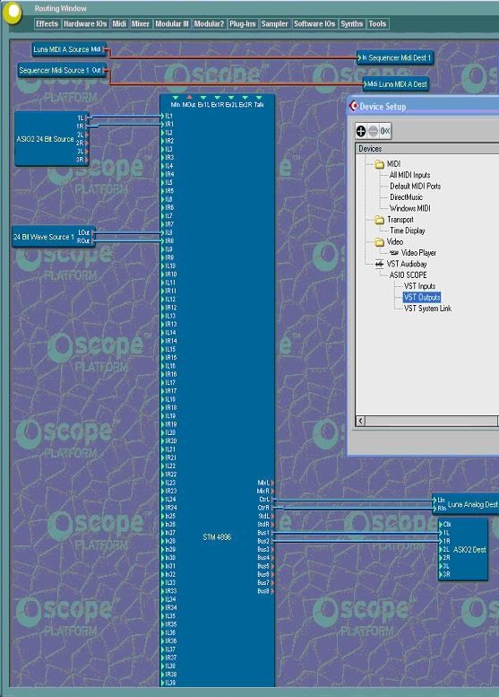

what else is running on your computer?
post a screenshot of your routing window...are you using asio drivers? you checked for active sensiong right? how did you check for shared irqs?
Re: constant crashing when recording
asio2,yes checked active sensing n midi monitor didnt pick anything up when wasnt playing, checked irqs as described earlier in this post.

- scrrensht1.jpg (116.21 KiB) Viewed 2760 times

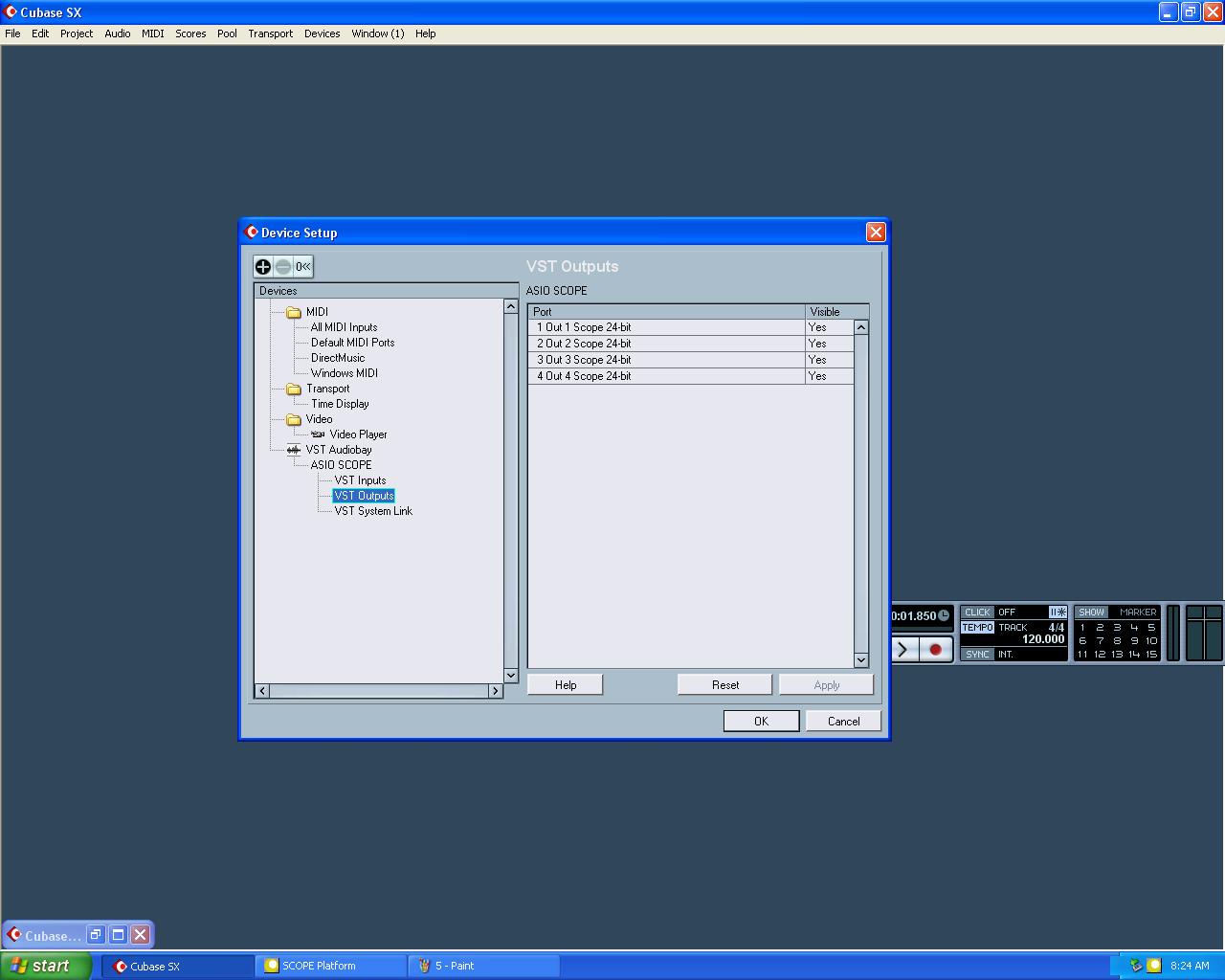

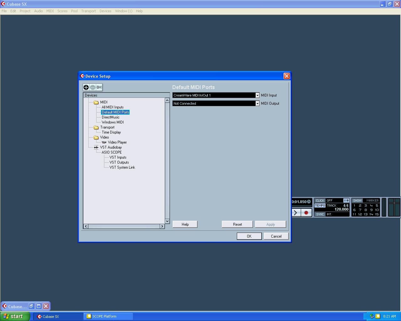

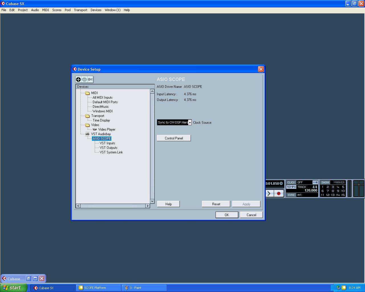

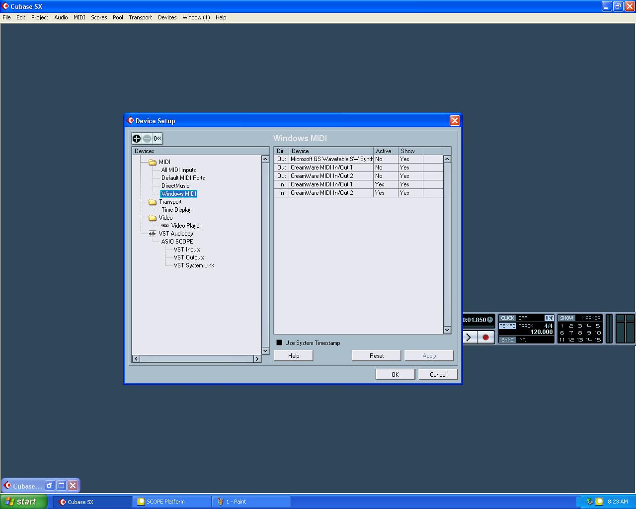

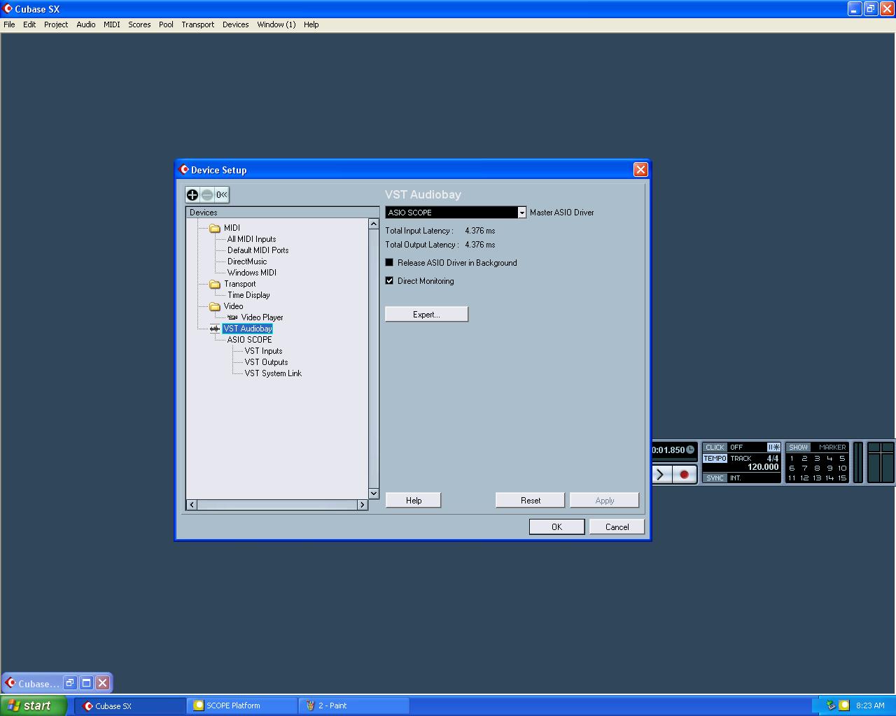

useing original cubase with dongle, checked hardware evrything looks good and isnt very old...heres a bunch of screenshots of cubase device manager
- 3.jpg (87.89 KiB) Viewed 2684 times
- 2.jpg (96.12 KiB) Viewed 2683 times
- 1.jpg (82.02 KiB) Viewed 2682 times
- 6.jpg (91.58 KiB) Viewed 2841 times
- 5.jpg (91.26 KiB) Viewed 2841 times
- 4.jpg (86.41 KiB) Viewed 2840 times
