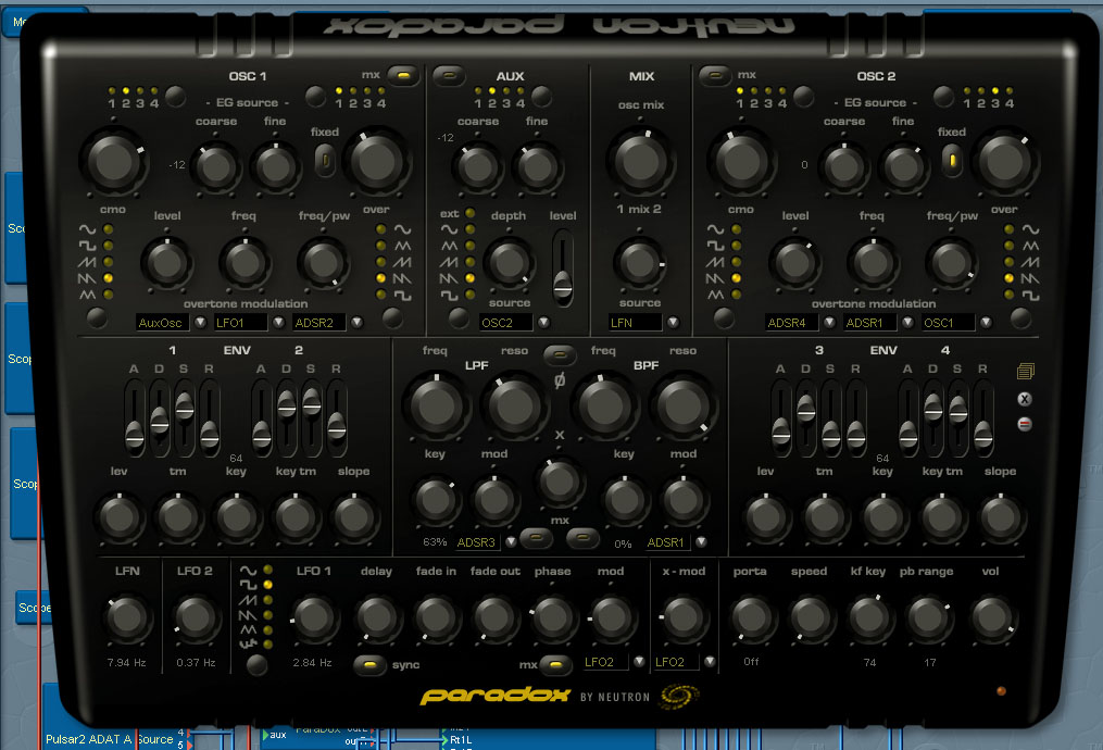

That's Exciting,
I especially like the backview as if we were staring at a real synth from above.
You weren't fuckin' around were you....
This kind of comsmetics and design combined is quite powerful.
Congradulations.
Congradulations.
Re: Teaser :D
well you can thank Shroomz for the fantastic design. mine was quite lame
the actual synth works quite different from the usual fare. the 2 main oscs are composed of a core and overtone waveform, the overtone is freely adjustable in frequency yet never goes out of tune (the paradox)
it works like a casio "phase distortion" which is nothing more than a sync oscillator with the transient when the oscillator resets muted out (and casio always used a saw wave).
in this synth it is done by a rotor which is like the creamware "rotor" but externally controllable rather than a built in oscillator.
in this case the core waveform is also the sync signal, and when the overtone is reset (which always happens on zero crossing) the level of the overtone is zeroed by the controllable rotor (also controlled by the core osc)
as far as i know the casio one only used a saw wave to control the amplitude of the overtone, done with a simple VCA, but the rotor makes it possible with any waveform.
the core and overtones each have their own VCA controlled by one of the 4 envelope generators. there is no "final" VCA so you can get a more dynamic and natural output with different envelopes for different parts of the sound. (it does mean the filters cant be self oscillating though)
the aux osc can be used as a modulator and/or output,
modulation is quite extensive, including MOD-X which can control the amount of modulation of other souces by a second source (virus style) modx knob can be assigned to modwheel to great effect.
best of all you should find yourself PLAYING MUSIC with the sounds you get.

Looks really pretty now !!! The user interface is more intuitive so.
And thanks for the explanation of the principle used, though I have to check if this is really similar to what is implemented in the Casio to be sure to have understood the principle.
If so I could sell my CZ-101
CheerZ

Looks fantastic. I wonder if sonic-core does a little private happy dance when something like this appears. These devices do a lot to keeps the platform  alive and viable for many of us.  Cheers!

Very exiting! Design is a+.If it sounds as good as it looks this will be a winner.Thx in advance.
Re: Teaser :D
that certainly looks impressive, can't wait to hear the bad boy, the cross mix on the filters looks amazing band passing and lp'ing at the same time, wicked
