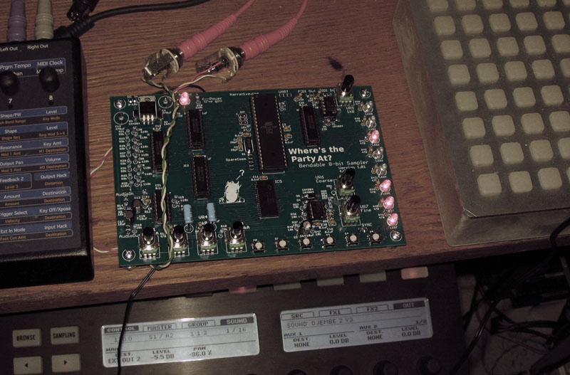

today i built a "where's the party at" board, its an 8 bit sampler,
