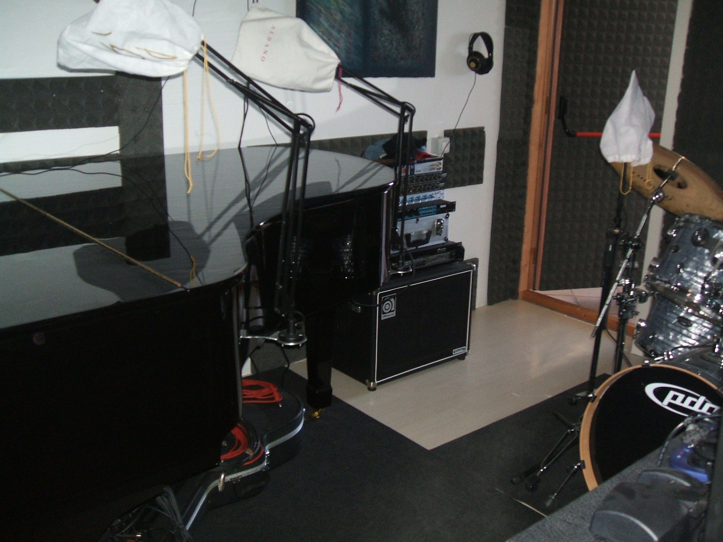

Re: the best choice
two scope 30 dsp in the pc master dual core
luna in second pc dual core
master key a 80
pcm db1s monitor active
yamaha mp5 active
pcm 91 reverber lexicon
tc electronic 2000
2 noise gate drawner ds 201
presonus digimax 96 hz pre 8 canal
uad 2 610 pre tube dual mono
limiter compressor tube tech cla 2 b
pre alto hp6 8 canal headphone
spl mtc 2831 controller monitor
frontier designer wireless trasport
mic neumann km 184 pair
rode nt 5, nt 4,
neumann tlm 193
akg drum set six mic
coda piano yamaha
drum acustic pacific
basso ampeg svt 3 tube
brunetti guitar rock it
pre 1000 .
stratocaster american
bass status preamplificato
martin acustic
ibanez acustic
fender classic

Re: the best choice
qui
- studio.JPG (122.71 KiB) Viewed 1355 times
- DSCF1025.JPG (899.12 KiB) Viewed 1357 times
Re: the best choice
sweet
The focusrite octopre (8 preamps in 1u with two Hi-Z inputs for instruments) is a great match for the A16 ultra (need two octopres to get 16 inputs). If you need 32 inputs you can double that configuration.
With that you can use your UAD 2 610 for vocals for example, and also use your PCM91 as an external unit (through AES/ABU if you have a plus plate or an XITE, or analog through the A16)
If you have a higher budget, and want a higher end multichannel preamp, there's the focusrite ISA 828, the SPL gainstation 8 or the ams neve 4081 (quad mic preamp.. need 4 of these for an 16)
The advantage over a mixer is that you can get the 32 inputs in less than 10u, which is great if you don't have the room for a big console.
If you have use for the console in addition to the scope mixers, then a good old analog soundcraft (like the delta that someone mentionned in another thread, or the studio series) will sound better than the yamaha 01V, and are more comfortable to use (but they're also bigger.. like 1m60 wide for a 32 channel mixer). The mackie onyx series have also very good preamps.
