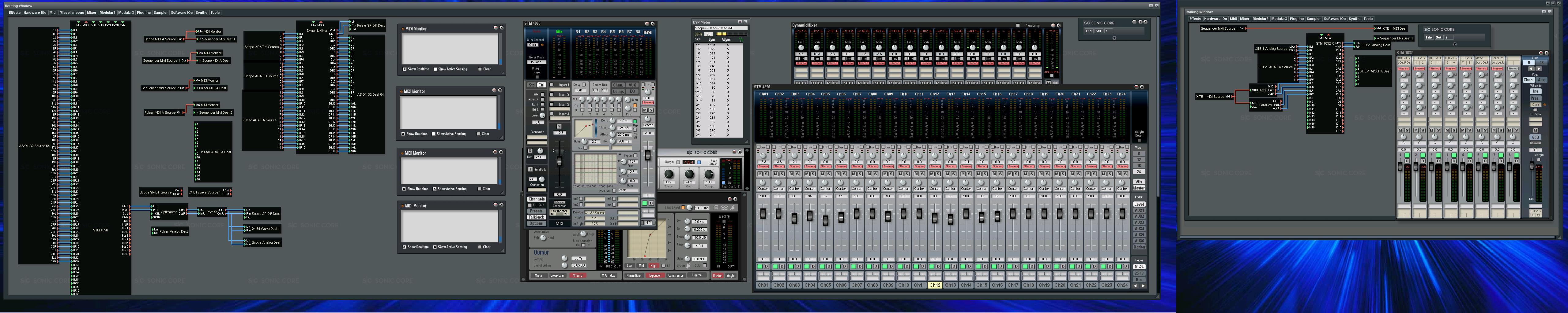

SUCCESS!
Scope PCI and Xite do indeed run on the same machine - (so save your PCI cards).
Xite feels powerful even just opening projects/modules and navigation.
Can't wait to finally jump in. However it seems I don't have keys for most of the synths (prophet, etc.) - so I'll be checking out the Atze and Paradox for now.
Below is a screenshot showing proof (covering 4 monitors)
I really hope S/C can grow this little effort and take on the UAD's of this market segment (as relatively small as it may be) - Xite is a fine piece of hardware deserving of some major acceptance by serious people.

- Scope_PCI_Xite.JPG (793.67 KiB) Viewed 4954 times

This is great news, but I don't see the MIDI A Source modules from each application in the same project window.
Can they be combined like that?
It seems as though you have 2 x different projects and 2 x monitors.
If you have time could you check that out for me.
I want to use the Scope MIDI A Source and the XITE-1 MIDI Source module in the same project window.
I don't mind tearing apart the DAW this weekend and trying it, but it would save me lots of time if you could verify for me.

Mine too...Pulsar midi & XITE midi in the same project...but killer good news so far..nice work!

can't do that. there are two seperate project windows.
