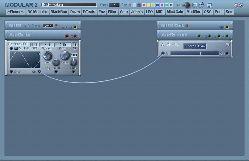

My question is in the topic, but here is a screenshot:
I can't connect LFO out directly to MIDI, which looks quite normal.
But how do you send a particular mod signal to a midi ctrl for some synth out there?
- ModLFO.JPG (42.32 KiB) Viewed 5410 times

you already answered your q yourself
by using a ValMonitor, plus right-clicking it's indicator / assigning a midi CC to it

Sorry Roy... I'm not sure to fully get it.
I can't connect the val monitor out directly to MIDI out. I searched through Flexor stuff but couldn't find any helpful module (such as convert freq signal to Midi CC or whatever). Seems like the LFO or the val monitor signal is audio or sthg!?

you don't have to connect anything to midiOut; if you assign a midiCC, Modular's midiOut will send the values believe me

a bit quantizice module between lfo and val monitor can avoid to much midi messages

THAT explains a lot of things, like "why the hell couldn't I find a mod patch with Midi out connected?".
