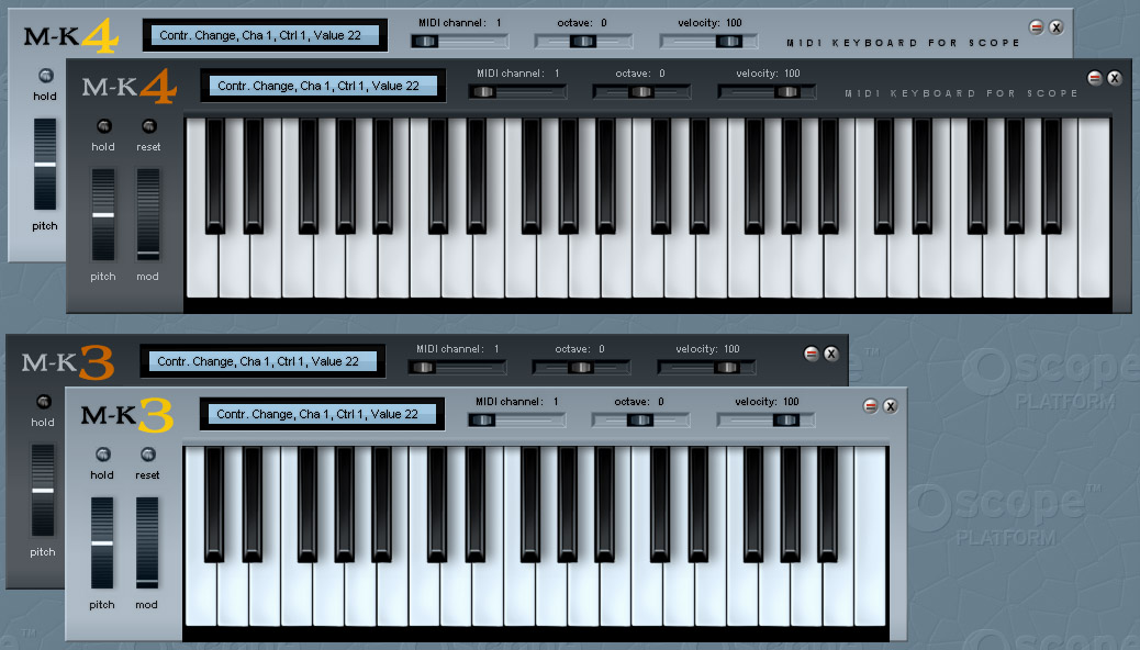

3 and 4 Octave MIDI Keyboards for the Scope routing window.

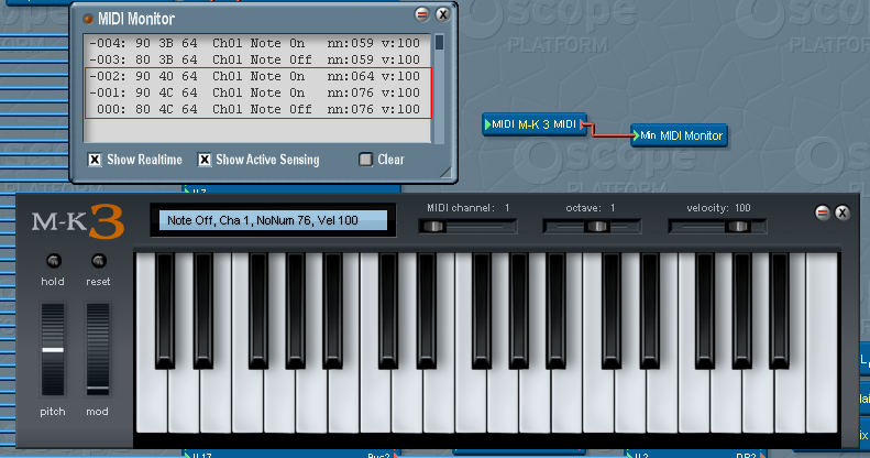

When I use the octave switch and then press a piano key two note on messages are send but only one note off message, resulting in hanging notes. See image. Anyone else have this problem?
sharc
Posts: 638
Re: M-K Series: MIDI Keyboards for Scope
Post by sharc »
Hi wouterz,
Yes it is a bug - not a feature :D - and one of a couple of small niggles I'll be looking to resolve for the next update.
In the meantime, all I can suggest would be to hit the reset button when you get the note hang after changing the octave select. It's not much of a solution for playing live, but then tbh I never really had that in mind when I created the device.
Thanks for the feedback 8)

sharc wrote:Hi wouterz,
