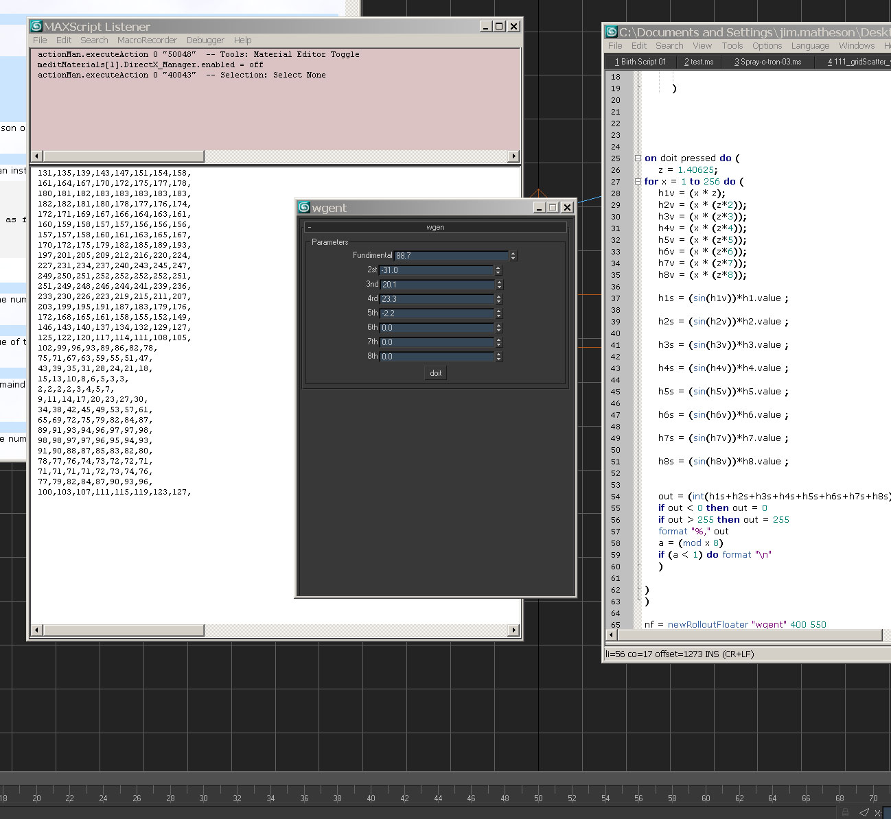

Of all things, 3ds max maxscript :wink: (slow day at work!). with this one i can make some waveforms by adding harmonics(+ or -). and it prints the properly formatted table right to the maxscript listener for copypasta into the arduino IDE.
now the osc works by taking 2 selected waveforms and morphing between them, poor mans waldorf :D

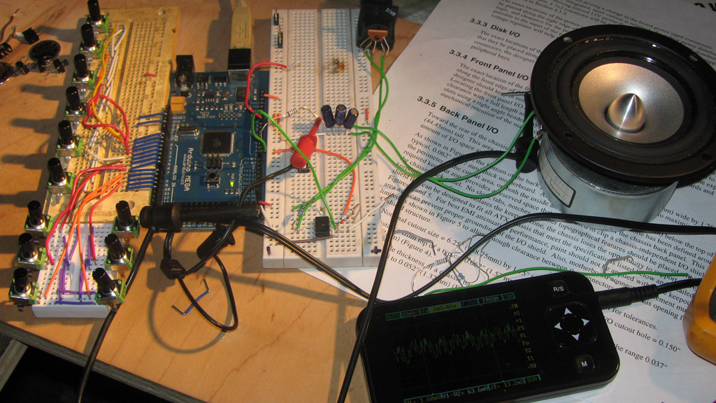

Here is one playing wavetables from MIDI.
Knobs are
wavetable 1
wavetable 2
mix
A
D
S
R
Lfo speed
Lfo depth
they are potentiometers, but i am going to change that to 8 encoders and an LCD (otherwise i just keep adding more and more potentiometers and run out of space :)
the sound is quite good considering it is just coming from a PWM pin. i am getting a little DAC for it though
I put in some of the wavetables made with Maxscript last night and they sound very good.
