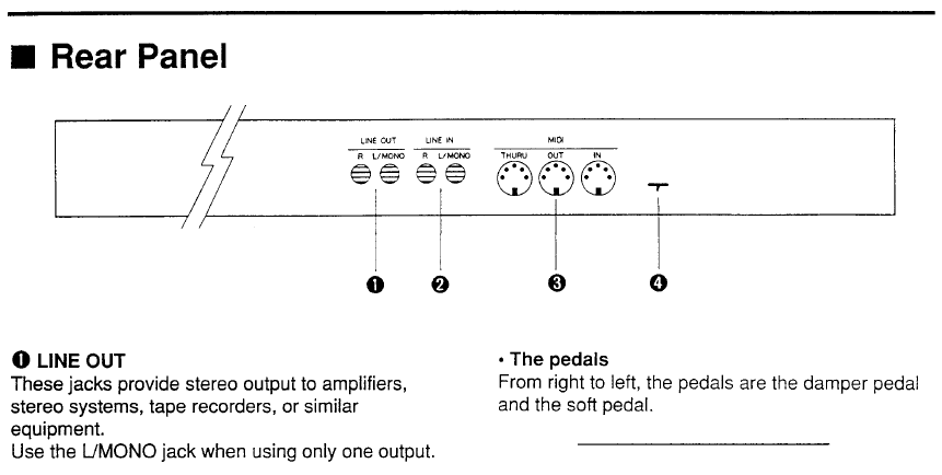

Now , I've plugged my Kawai MR370 , obviously made the necessary steps as I would with the Avalon but in this case with the xite-1 preamp.
So I've raised the volume of my Kawai, loaded the MIC/ DI source in the project window, connected it to the mixer, phantom switched on , hi-z switched on as is it an instrument , gain turned half it's max level. Now signal led is blinking when playing every thing seems normal so far, but it sounds so low , I don't think I have hearing problems cause I can tell the difference between what I can acheive with the avalon and what's coming out from the xite preamps.

Ähhhm.The kawai is a clavinet right? Why do you turn on Phantom power or high z? Phantom power is for condenser mic´s and high z for guitars(high impedanz input).I would guess the kawai spits out line level... :wink: It sounds so low because the preamp is expecting a high 1 mega ohm load on the input.Turn off high z and phantom power.

You should not switch HI-Z on, since the MR370's out is line level. HI-Z is for plugging in instruments like a guitar or a bass. :)
Phantom power is useless in this case. It's used for powering some types of mics and DI boxes

The Kawai MR370 is an electric piano, ofcours it's got it's own line that you can plug directly to any monitor , whether amplified or not. Look I've been using this instrument for years and I know how to connect it.
Connecting it to the MIC/DI does not sound at all , unless you switch phantom and hi-z, then it would sound , but you have to raise its gain in order to get some signal from xite preamps. Since my english is not good, perpahs I should put a video on you tube for you to understand what I'm talking about, but it will be in french or spanish,

This is a line level output. It does NOT need phantom power, and it's NOT high impedance.
The HI-Z, and Phantom buttons should be "out" (not pressed), and (usually for hot line sources) the Pad button should be "in" (pressed).
