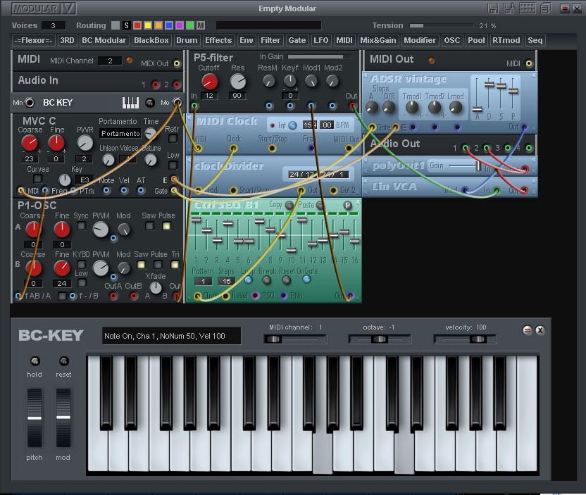

This works here, haven't got an xite so i cant try it there.

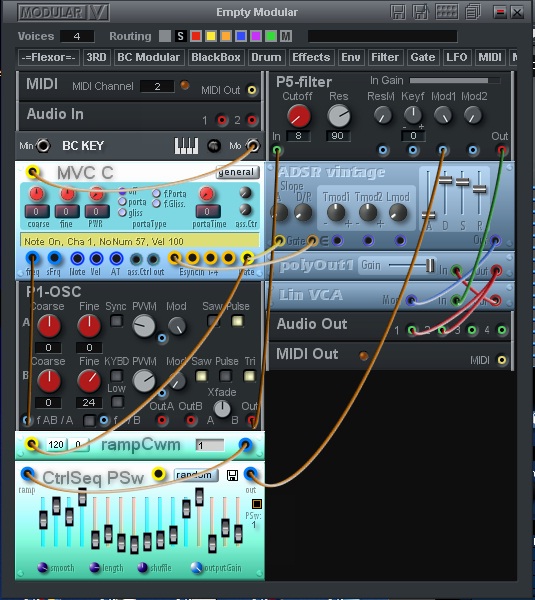

...But i much prefer this solution

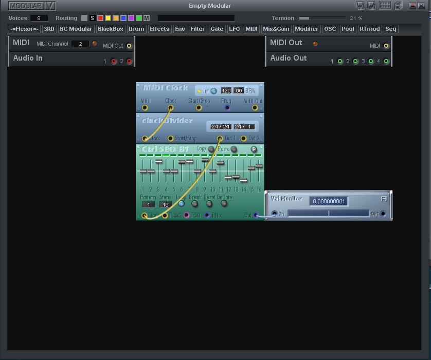

Ok, i just read further up you have flexor.
do a simple setup as shown below. see if you get any values out.
if its dead, and your vsti clock is blinking and the step indicator is moving, its buggy. if it shows values, the filters mod input is bugged...

I checked the output of the sequencer and got nothing.
Remembering a bug I had with Xor a while back, Assaf told me to re-install Scope 5 as sometimes files are overwritten that tends to break things. So, I just re-installed Scope and it works great!
