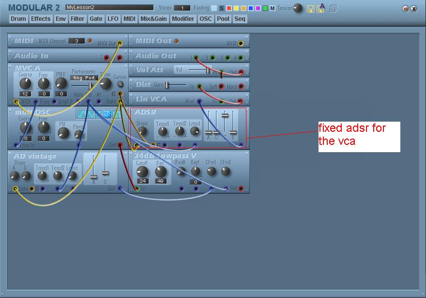

I understand:
The Volume Envelope Generator (VEG)
Sharp attack, exponential decay, fixed decay and rather long
time. (In the Devil Fish it can be altered between very short,
normal and infinite sustain.)
Drives the VCA and does nothing else.
to be meaning: exponential decay for the ADSR that controls VCA.
We should experiment with other adsr. Unhappily, I can't do that with Flexor at the moment, I'll get activation keys later on this week.
Thats the ADSR controlling the Lin VCA so :
So you want the attack fast / decay very high up so it dies out slowly and sustain/release at 0
Change the slope setting to exponential

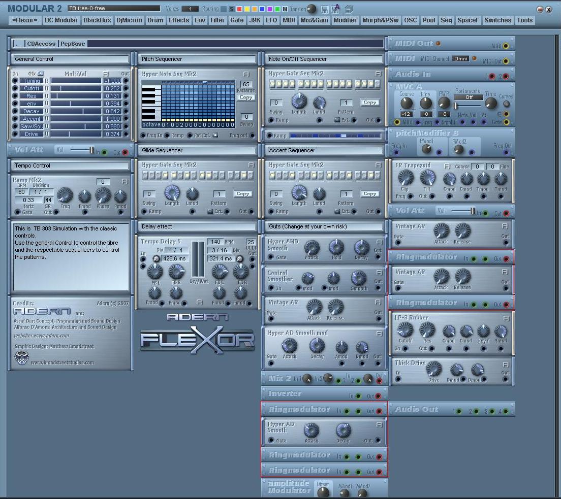

Right at0m I kind of stumbled across this today looking at one of the offcial flexor patches the tb free -0- free
In the guts of the circuit you can see the ring mods which in the case of the deacy is connected to the multi val and the amplitude modulator
crop expo env.JPG (202.58 KiB) Viewed 8220 times
The circuit that isistoy is the circuit we are working with so these additions wouldn't count in the homework anyway. It's just useful info I think

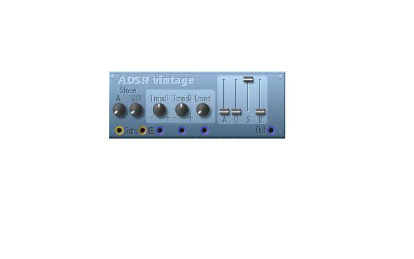

Isistoy this one offers the decay mod
adsr mod vintage.JPG (16.26 KiB) Viewed 8330 times
