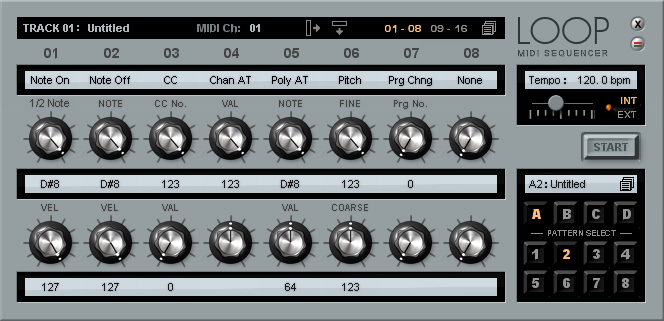

LOOP is a 16-step MIDI sequencer capable of Note, Pitch bend, Control change, Channel Aftertouch, Poly Aftertouch and Program Change message output per step. 32 patterns can be stored and recalled either from the device panel or via incoming MIDI notes.
Updated to Version 0.6
- Added note length parameter
- Added track and pattern presets
- Patterns can be switched by incoming MIDI notes
- This version is currently limited to 1 track
Known issues which I'll try and fix for next update:
- Note hangs when switching between patterns and adjusting notes while note is playing.
0.6b Update
Bug fix in Track Presets - Pattern Names now stored. Added Extend Horizontal / Vertical buttons to make 16 steps viewable at once.

- LOOP screen.jpg (166.87 KiB) Viewed 13527 times

Ooooh, looks very nice.
Will there be some indication of where you are in the sequence (LEDs etc.) in the final version?
Tempo set to Ext doesn't seem to work (jumps to 250 bpm).
Would it be possible to have a 'Key On' assign so that one could program a note into a sequencer and trigger it that way?

YesMr Arkadin wrote:Will there be some indication of where you are in the sequence (LEDs etc.) in the final version?
That's strange. It tested OK in the SDK, but now that I try it in Scope I see what you mean. Should be easy enough to fix.Mr Arkadin wrote:Tempo set to Ext doesn't seem to work (jumps to 250 bpm).
The final version will have pattern selection from MIDI note events. Start/Stop triggering from MIDI Note On/Off is possible, but it will effect all tracks at once.Mr Arkadin wrote:Would it be possible to have a 'Key On' assign so that one could program a note into a sequencer and trigger it that way?
It's not what's intended with this device Greg. Adding chord tracking functionality would take resources away from other features. However, it's possible that I'll produce something like this in a future device.siriusbliss wrote:How about chord-follow/tracking?

Ive played around with this for a bit, and it is absolutley a missing link in the Scope system.
The lack of note length control makes it incompatible with minimax note change (and i guess others that have the same note priority system, allthough i haven't found any others yet), but i guess thats fixed when note length is implemented.
Now I'm only waiting for the sync station an the pattern sequencer, and my life will be fulfilled

Re: LOOP - MIDI Sequencer
Is the NoteLenght under construction ?
Is PolyAT useable as an input assignment (just to be able to manage this one with the same BCR template as for the NOAH ...
CheerZ
CheerZ
The note length is done, but I haven't implemented it in this device yet as it will take some time to add. With that in mind, if you have any requests for available note lengths, now's the time to let me knowHUROLURA wrote:Is the NoteLenght under construction ?
There will be a LOT of parameters in total in the final version and PolyAT input is one method I'm considering for getting full midi control. It would more than likely be used in a fixed fashion like the Noah though as opposed to an assignable control method.HUROLURA wrote:Is PolyAT useable as an input assignment (just to be able to manage this one with the same BCR template as for the NOAH ...)

Please just choose the same assignment as for the NOAH and I will provide the dual - BCR 2000 presets !!!sharc wrote:There will be a LOT of parameters in total in the final version and PolyAT input is one method I'm considering for getting full midi control. It would more than likely be used in a fixed fashion like the Noah though as opposed to an assignable control method.HUROLURA wrote:Is PolyAT useable as an input assignment (just to be able to manage this one with the same BCR template as for the NOAH ...)
Regarding the step number, would it be possible to get a version with the whole set of 16 step available at once rather than switching the 1-8 / 9-16 selection just as an alternative (they way you implemented it is great for people having only one BCR unit or other controller providing the same set of 8 controllers) but for me a full 16 step at once just as the one of the NOAH would be just great.
Regarding the notelength, the setting availble in the NOAH are just great ...
CHEERZ
At the moment the sequencer is running at 24ppqn synced to a MIDI clock module. Timing wise it's not possible to deviate from this clock in terms of step position and length without manipulation of the clock trigger itself or adding some sort of MIDI delay. I'll see what I can do on that front, but for now I can't make any promises.
LOOP doesn't/won't have the same parameters as the Noah sequencer, but I'll look into matching up MIDI control assignments where applicable.HUROLURA wrote:Please just choose the same assignment as for the NOAH and I will provide the dual - BCR 2000 presets !!!![]()
Already working on itHUROLURA wrote:Regarding the step number, would it be possible to get a version with the whole set of 16 step available at once rather than switching the 1-8 / 9-16 selection
