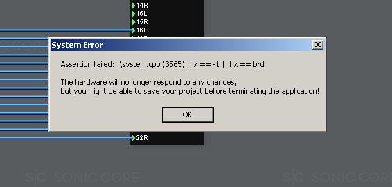

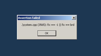

Hmm...new system installed. I am getting following errors when i try to load some of v4.5 projects(see attachment). Weird... After i click on "OK" i get next screen. After i click "ok" on next screen project is loaded but it is not usable. I can r-save it but that is not helping when i try to load this new saved project. I am getting same error. Some v4.5 files load without any error, some "load" with this and i can't do anything with project. These v4.5 files are loading in v4.5 without any error. Any ideas?
Windows XP, fresh install, latest scope v5, no v4.5 previously installed, scope 5 installed in default directory..
cannot load v4.5 projects in v5
- first error
- error1.jpg (6.16 KiB) Viewed 751 times
- second error
- error2.jpg (17.84 KiB) Viewed 750 times

Well if anyone is interested or if anyone will run in to same issue here is how to "fix" it:
I am not clear how is this connected with issue but all you have to do is to edit cset.ini in Scope5 directory. Be sure to make a copy of cset.ini just in case. Open cset.ini with notepad, find "LOAD" area and from this:
[LOAD]
AlignSurfaces=1
LoadMixer=STM 1632.dev
LoadMixerEnabled=1
LoadDefBoard=0
You need to change it to this (of course if you have two cards like in this DAW in which i am working on...i've added old very old Luna to boost some DSP):
[LOAD]
AlignSurfaces=1
LoadMixerEnabled=1
[board0]
boardid=1
[board1]
boardid=0
LoadDefBoard=1
After that i can load v4.5 project in v5 without error. If you are too paranoid about leaving cset.ini edited you can then re-save project in v.5 and then revert back to original cset.ini. Project will load without error.
Strange way to fix this but it is working.. I don't know why it is happening but for fixing few old v4.5 projects and to make them load in v5 it will work.
