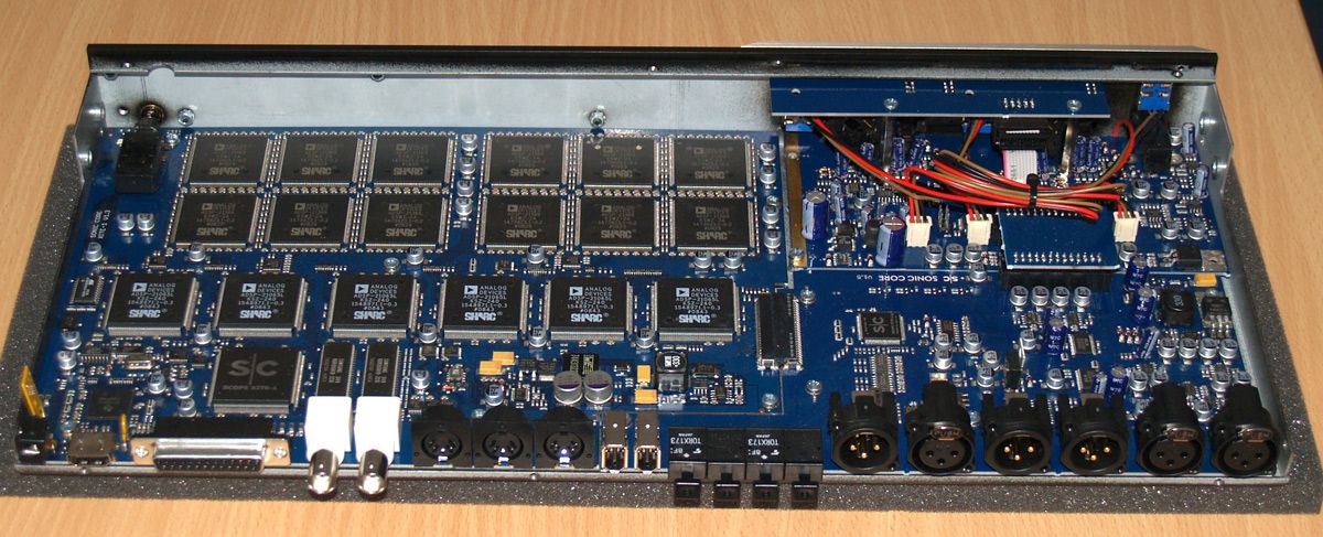

Re: 64bit Testing
My understanding is the RAM is inside the new DSP chips (12 Chips)
Certianly I think there quite a bit of optimisation to go - probably in the third party area, but I get the odd DSP error from time to time on some of Sonic Core's devices. Manual DSP placement usually does the trick

Re: 64bit Testing
Ok thanks mausmuso, thats what I thought - more opto to go - great pic I've never seen inside of XITE-1 before.
Re: 64bit Testing
The picture came from a Germany magazine article I believe.
If you search the Z its posted here somewhere.
It might be a good picture to add to SCOPERISE as some point, although I don't know about copyright associated with using it?

Re: 64bit Testing
Can't recall for sure, but my PCB experience (and if I recall earlier discussions correctly) makes me think that the RAM chips for the new DSP are on the bottom-side of the board.mausmuso wrote:My understanding is the RAM is inside the new DSP chips (12 Chips)
I don't see the purpose in building RAM into DSP topology.
Re: 64bit Testing
[quote="siriusbliss]Can't recall for sure, but my PCB experience (and if I recall earlier discussions correctly) makes me think that the RAM chips for the new DSP are on the bottom-side of the board.
Greg[/quote]
Interesting, I seem to remember asking the RAM question sometime back and the answer was the RAM is built into the DSP chips. I guess it does'nt matter as long as it is there and it leads to better devices.
Greg[/quote]
Re: 64bit Testing
both is true - the DSPs have a certain amount of processing memory (on chip, like a CPU cache) and there's additional DRAM on the circuit board for 'extended' use.
On the former 21065 DSPs on-chip memory was really tight which lead to the situation that longer delays quickly ran out of juice and accessed the PC mobo's Ram. The infamous PCI bus load...
I don't have the figures at hand, but the new DSPs probably have enough local memory to handle every existing reverb plugin internally.
If more Ram is needed (for whatever purpose) it doesn't have to be requested from the host OS (and hardware) anymore - a big step imo.
Re: 64bit Testing
Thats what I was wondering about - if reverbs happened completely inside the SHARCS. Guess the answer is Yes. The other reason for the question - just reaffirming that the platform hasnt yet reached its full potential - theres still juice left in the development tank performance wise. Coz thats the view I'm gonna push in ScopeRise.astroman wrote:I don't have the figures at hand, but the new DSPs probably have enough local memory to handle every existing reverb plugin internally. cheers, Tom
