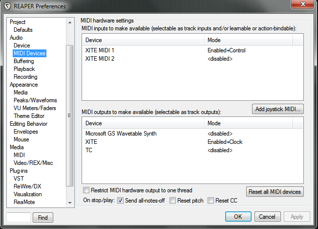

It is from Reaper.
Options/Preferences/MIDI devices/ - on bottom page (on stop/play), deselect "reset pitch", "reset CC". and "send all note off"
				- reaper.png (60.46 KiB) Viewed 2689 times
