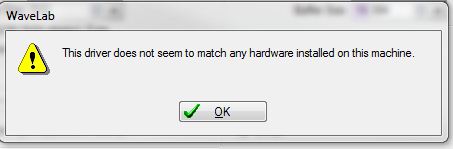

I updraded from scope v5 to scope v5.1 (Win7 32bit), before i used wavelab 6 with asio scope pci drv without problems !
Now i got a error ,see attachment !
Already deinstalled scope and wavelab 6 , first reinstalled wavelab and using generic asio drv ,then reinstalled the scope 5.1 and vice versa , same problem !
I can use the MME driver for scope but there is a hughe latency ! was mutch better wit the asio scope pci drv !
anyone with a solution ?
payed 98€ for nothing , keyfile from v5 is also working the only difference i have in keyfile v5.1 is 'SC SCOPE v5.1 Application' and just have Arpeg02 as extra plugin !

Why did you buy it?Only difference is the 64 bit driver (and the arpeg 2?).Hopefully you get the next update with bugfixes(which need to happen) for free.
The error is strange.Did you try different asio modules?Maybe 2 ch only will help.

Yes i tryed different asio modules , I also have Win7_64bit that i use for xperiments but have the same problem !
Now i gonna put my C; drive backup with scope 5 and just upgrade from there without deinstall and see what happens !

Ok,
I have my backup back with scope v5 and just upgraded to v 5.1 and wavelab is working again !! ( 64bit not )
So when i first deinstall v5 and then install v5.1 , asio scope driver is not working for wavelab !@#|&!!! :o
