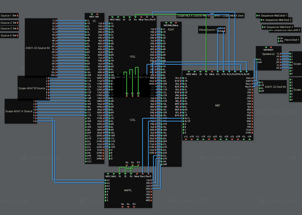

I bought the modular mixer a couple of weeks ago and Id like to change my "basic project" to a modular-mixer environment.
Most of my projects look something like:
It works for a great part of the job, but has some drawbacks:
-the sidechain function of the stock compressor (and vinco also) doesnt work properly. When I use the stock compressor i manually have to reset the SC input for all compressors used.
-when i load more than one instance of a synth, i mostly have to recall my presets because it seems they get some sort of midi message which resets some parameters or silence the sound.
When reloading a project like this, it usually takes about 5/6 minutes to reload all presets to their original state, which can be very annoying sometimes..
So , would it be advisable to give every synth a seperate "midi seq source" so any "leaking" of midi messages would be kept to a mimimum?
Also, what would be the best modular solution for replacing a project like this? I like the idea of having 2 mixers like I have now, 1x for drums, 1x for synths. I have my PCM91 daisychained in AUX1 both mixers .It would be great to have the modular-sidechaining functions implemented, so i dont have to use the stock compressor which is bugged..
(I use a midisport 4x4 with cubase for sequencing; also for my external virus C and SE1X)
Any suggestions would be welcome.

Hi RP,
The way to do it is to count the number of mono and stereo channels in the whole project, and then take the Modular Mixer modules that come closer to this setup.
You use 2 mono channels, and about 20 stereo channels. The closest number to 22 is 24 inputs (actually, by looking again at the picture, you have around 24 channels, as you also use the T-Channels as stereo channels... didn't noticed that at first glance)
I would use the FP4L + 2*10S (to keep two modules for asio and synths). (or, one of 10, and one of 12, for example)
But what I do not see is the number of Aux used.
For the moment, the modular mixers offers groupers of 24/6aux (R247) or 24/4 (R245), going to an MB7.
The choice between a mixer using the Levelled modules, or the Stems (groupers with Levels+mute/solo ie all that is essential in a mixer, but without a single insert slot) is really up to you.
Stems are good to have all essential functions of a mixer in a single module (mute/solo/levels/sends), while effects are either directly in the project if you use only a few, or if you use "non-levelled" channel modules (have only inserts + mute/solo) to keep it more tidy.
You could also imagine a mixer made of a mixture of FP and Modular mixer for example (it allows to use a lighter router and MAster Bus modules).
For the sidechaining, the Sidechainers will allow to keep the presets/project setting on project reload, but curently only allow 2 Sidechain signals inputs (to route to whichever channel you want).
Sidechainers don't use a compressor, but only the VCA Part of a "compressor" (ie similar to compressor with threshold= - inf.dB).. so they remain quite light (much lighter than using compressors).
As for manual, there are a few tutorials on my site, as well as description of various modules and projects (see also the project galery as there is text in the picture - you will find projects wich go over 24 channels and that are close to what you want to achieve in the spirit (check the "36 channels projects). From there you can expand the explanations to setups of yours. It certainly does not present all scenarios possible as it is difficult to predict all you can do with such mixers. By using the smaller Groupers (G 62/82 , or Routers of 12) you can do more sophisticated setups by submixing various groups of your mix (with more cabling in the project window though...).
Then, there is the "dsp assignment" of xite with is unknown to me, but if you are able to use 2 FP Mixers + 1 MB4-II and all the synths etc in a single xite project, then it should be no problem to build a big modular mixer setup (I cannot test this, I rely only on what poeple say and pictures they post, as I have no other way to determine what is appropriate on Xite).
I hope it helps a bit.
Mehdi

Re: changing projects to modular mixer
I think this project allows the same channel and aux count in total.
I can't load as much synths so I've used adats modules and did not connect all the inputs, but the spirit is the same.
				- 20 stereo + 2 mono
- 20S2M.jpg (406.35 KiB) Viewed 7702 times

Thanks a lot guys for explaining! I will turn on my studio within an hour and try some of the tips above..
So far so good. I made a similar project like Mehdi did. I left out the mono channels because 2x12 stereo channels are more than enough for now. I will do the midi part tomorrow, as it seems i need some more midi cables. The project below is used with cubase. I dont necesseraly need it for a Live situation, but it would be great if i could do some "sketching" without a sequencer sometimes.  I havent used the Midi IN of xite yet.
I have a JX305 as masterkeyboard (to midisport 4x4) via usb, and also a BCR2000 midi controller. Could i combine these two as "One Masterkeyboard" for my xite midi in?? I dont use any sound from the jx305; it's only for playing notes..
First impressions are great Mehdi!! I hear the same awesome HP filters in the 12SL as in the FP106? and also panning pots !! And more accurate metering for the filter freq..
I will now try the sidechaining functions.. If I want the kick to be the SC input, should I only send a mono channel of the kick to the SC1/SC2 input on the 242?
I will update this later on, when i find even better connections..
p.s. Jimmy, Im not sure what you mean by "LFOing the PCM91..
Cheers!
Absolutely, why change a good thing
Yes, you need one input only , so you plug it to either SC1 or SC 2 (unless you want a stereo sidechain, then you would use both SC1 and 2..) ...
There are tutorials that I suggest to watch to find the right settings, it is easy to get lost between the "modulation amplitude", "offset" and "output gain"... while the "shape" of the modulation is mainly controlled by the input signal + Attack/Release of the envelope follower.
http://www.spacef-devices.com/index.php ... &Itemid=17
Let me know if you cannot get where you want to get.
Thanks for the pics , infos, and kind words
NB: a mono effect, or mono channel module, could perfectly be connected to a stereo channel with no problem In you setup, if you need a mono signal from time to time, you could load a mono effect rack (ora mono eq/filter/whetever) and plug it to the last inputs of the SC module (that's simply done by connecting the mono output to the L/R inputs of a stereo channel or SC module.

and of course the Sidechain modules can be put in any place in the circuit for creative sound shaping:
- pre-channels like on the picture (the basic sidechain technic)
- between channels and stems/routers (mainly allows "post-effect" Sidechaining, which can be fun on time-based effects like delays and verbs)
- between stems/routers and master bus (to group several sounds to be effected by the same sidechain: monopolizes a group output, but allows to use the smallest SC module)

Below is basically a Scope / Reaper config, but I have an 8 x 8 hardware merger,
and also use hardware effects, and Analog synths all controlled by the Oxygen
88 and Reaper. The Project Preset List is where these complex routings and options
can be stored and recalled.
Below I have an example of 3 sources of MIDI controlling my SE-1.
I am playing the notes on my hardware controller ( 1st data stream )
Then the Modular patch is sending MIDI for Filter Modulation ( 2nd Stream )
And Reaper is sending volume, effects levels, delay rate, envelope and resonance
modualtions, etc. ( 3rd stream ).
I see no sense in recording the audio of the SE-1 since the sound is degraded, but having all of its MIDI recorded is an enhancement.
It's nice to be playing the synth notes on a controller and have everything controlled automatically.
So if this type of complexity can be used in realtime, I see no reason you can't achieve similar gratification.
My success comes from using the Project Preset List to recall snapshots.
