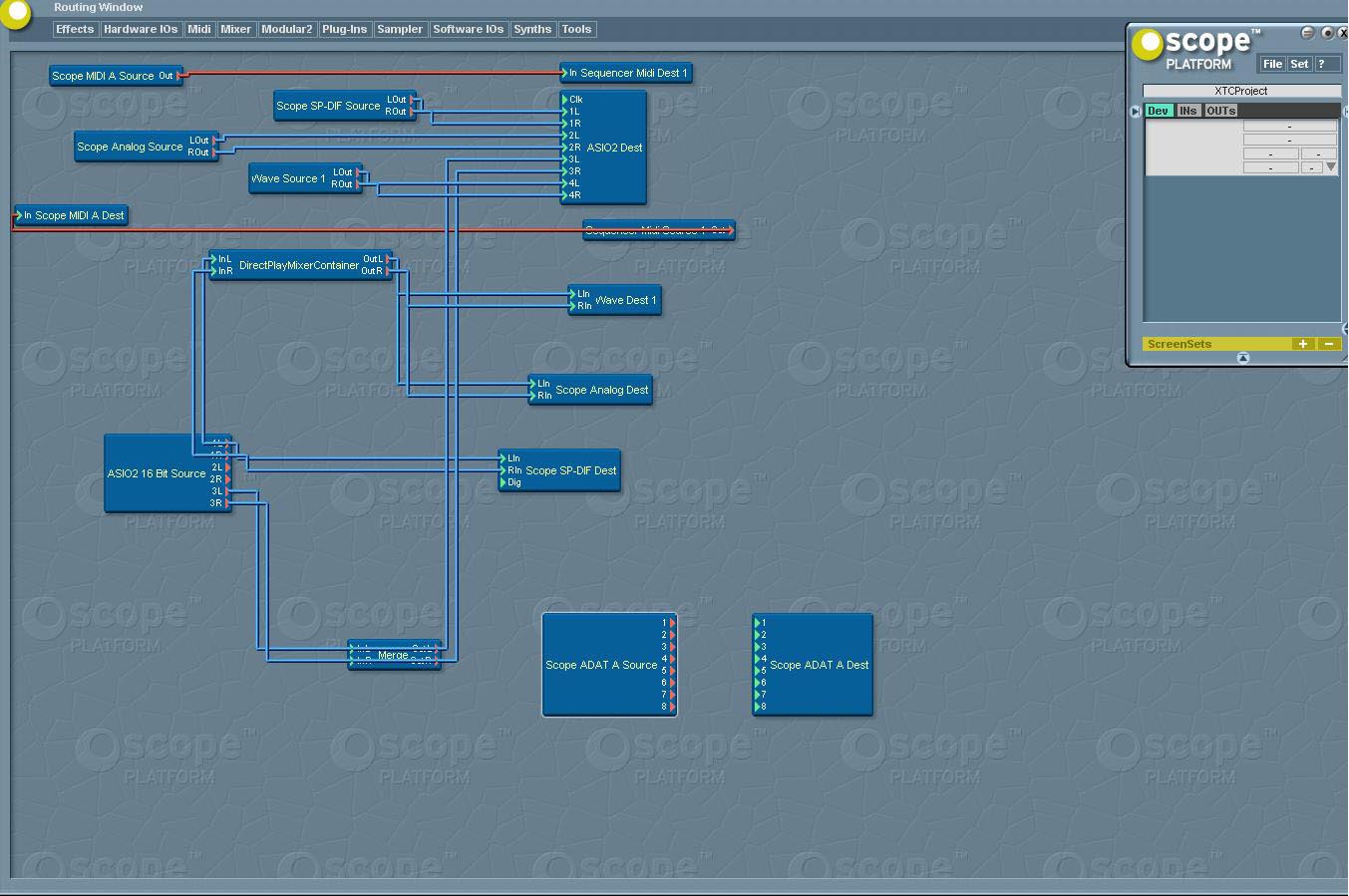

attached picture of my *. pro project
i would like to figure it out where to connect adat source and dest.
should i plug some plugin to let it works? such as vdat perhaps?
Should i extended Asio channels dest/ source?
thanks
thanks

change the number of asio ins/outs by clicking the asio boxes. THey should have 8 in/out.
Then connect the asio sources to adat dest, and adat source to asio dest.
you can disconnect the "merger" module for now and just leave it somewhere in the project window, unconnected. the same goes for the directMixerPlayer. well talk about them later.
Then fire up your daw (reaper cubase, pro tools etc) while scope is still running.
Do you have sound?
if yes, save the project and close your daw, then after that scope, and then load up your daw again.
that should be it:)
