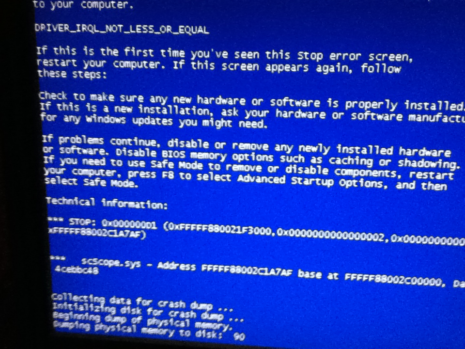

i discovered oddly that theres a few certain adern flexor3 patches that will consistantly give me this bsod everytime i load, i took a pic of it below

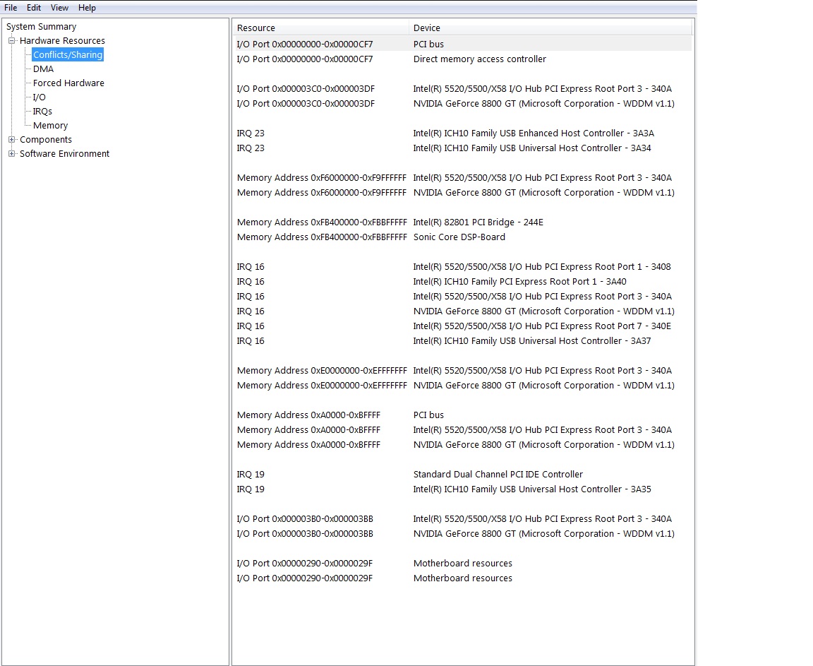

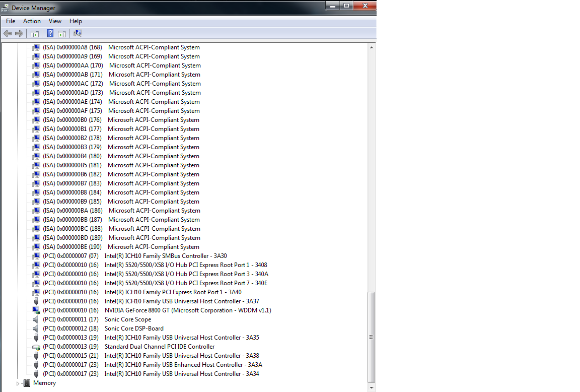

i also attached pics of my irq's theres only one conflicting with scope card: intel 82801 pci bridge 244e, cant disable it since wont recognize scope cards if i do...

imho the cards are configured perfectly with their own IRQ 17 and 18 - don't see any sharing on the screenshot...
