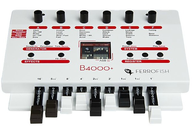

				OK, looks like there is an ASB renewal in the air.
I like the use of the small TFT LCD. This is what I miss most on previous model especially for local preset management.
I also felt it was a nice idea in the A16 MK II.
The look is quite different.
No more wood, more in the Waldorf Blofeld spirit bent on the front white metal box.
I just feel there are less control as in the former CreamWare B4000 ASB but maybe they found a trick by using the LCD.
Looks like there is smart parameter matrix in the spirit of what is also found on a Waldorf Blofeld, but I guess the small LCD is one of the smartest addition we ahve seen to provide the feedback to the user.

				I hope you like our new B4000+...the old B4000 needed some facelift, now it looks more modern and attractive I think.
As you surely suspect, the B4000+ is based and developed on Scope/B2003, its really still the best platform to develop audio hardware!
Concerning the DSP code, compared to the old B4000 we have a new rotor code now, also added a nice reverb, and did some smaller enhancements and bugfixes.
But most work was put in the user interface, as you see the B4000+ has a TFT display, and also a fast ARM processor is doing all the controller stuff.
It's really fun now to play with the parameters, although the old B4000 had some more knobs, you can now edit >all< parameters on the B4000, so no need for PC to fiddle around there any more. Also we replaced the encoders now by six "endless" potentiometers with metal shaft and cap. They have the same resolution and feeling like potentiometers, but can be turned endless (dont have an absolute position). Below some TFT screens of the B4000+.
We're still working on our website for more information, but feel free to ask here or on my email if you have questions for the B4000+!
Greets - Juergen

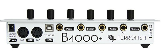

Just a few question regarding the user interface which looks quite straightforward:
- how do you select the parameter row ? I suspect selecting it also select the correct screen but I do not see how to do it.
- what are endless potis, encoders without detent or ? are they also push type to allow them to be used for switch parameter on/off ,
- what type of ARM (I guess the same range as for your beautifull A16 Mk II), what type of DSP (same as in the Xite) ?
- I guess from the screenshot that you add also a compressor to the effect range ... is it based on a known scope device ?
Nice work anyway, the B4000+ is the first scope based device available since the Noah which allows complete standalone use but with a much better thought user interface. Any other ASB II under developpement ?

Concerning your questions:
Right, you select the screen using the keys, then you can adjust up to six parameters using the dials. Some keys have more pages (like rotor->horn->bass), you press the key repeatly to toggle between the screens. Also, some few used functions you can access by pressing the key long (written in red on the panel).
Its very intuitive and easier as it sounds here
No, these are real potentiometers, to be precise: two pots in one case, one is mounted with 90 degrees angle so when reading both pot positions we get the position of the shaft. It has a much smoother feeling and higher resolution as an encoder.
Its a Cortex M3 ARM, the controller software is written completely in C++. We used a different Sharc DSP, but from the same series of DSP's. It's the ADSP-21262.
Yes, its a Scope compressor, only few modifications for easier use.
-Juergen

A few more questions:
- what are the size and weight of the B4000+ ?
- what is the use of the USB port (USB MIDI IO, firmware upgrade, soundbank transfer or even editor ?)
				Re: Ferrofish B4000
				Posted: Mon Oct 10, 2011 4:09 am
				by JuergenK
bit less than 2kg, and 24cm x20cm x 5cm
Yes, all of that. Because the B0400+ has now 16 soundbanks, I plan for a program to organize the presets (rename, rearrange, and save/load them).
Also you will be able to upload a logo screen to your B4000+, and maybe do other mods.
We thinking of integrating all of these programs in one software.
-Juergen
