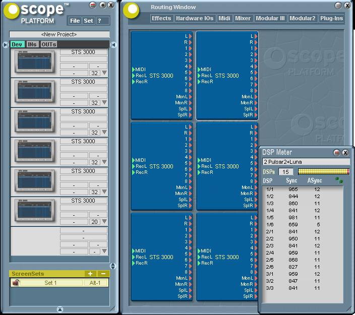

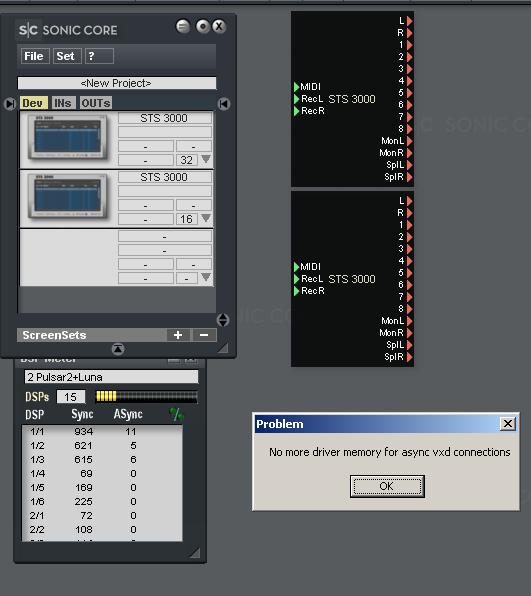

Re: "No more driver memory for async vxd connections"
Bumping this as I am getting this error as well.
I finally reinstalled V5.1, and this error appears in Scope only mode after adding a second STS 3000 sampler or using more than 32 voices for one STS .
Thing is I was able to run two STS 3000 in Scope 4.0 with no issues.
I also tried this with no other devices running in SFP mode(I don't use XTC)

- SFP V4 loaded 2 sts 3000 with 32 voices each with no problem
- uhoh.JPG (40.75 KiB) Viewed 3957 times
Something has definitely changed between 4 and 5.1 in regards to this error. I reloaded 4.0 to see how many STS 3000 I could load on my cards and here is the result...
On 15 DSP's Maxed:
5 @ 32 voices
1 @ 20 voices

On my XITE-1D I can only load one STS5000 at 32 voice polyphony, then the second one gives the async error.
On my PCI cards (12DSP) I can load 6 at 32 voices and dont get the error yet.
Both are running Scope 5.1 (WinXP 32 bit 4gig RAM)

I've added 7 Profit-5's (1 voice each) and with the 8th there is this message.
Is it related to the XITE-1 Hardware or to my PC-Hardware or to the PCI-Express-Interface?
Cubase 6.0.5. 32 Bit Win7
Intel Core2 Quad CPU Q9450 2,66 Ghz
INTEL DP35DP
This seems only related to Scope 5.1. I have neither cubase or studio one and recieve the error when using Scope 5.1 standalone with no other software loaded. No such error in 4.0.

My system is based on Scope pro PCI with Scope 5.1 on w7 64 bits , very sensitive to PCI overflow issues and currently limited in term of asio outputs (as the mobo is recent, it does not handle PCI as well as 5 or 10 years ago).
I cannot tell anything about XTC as I don't use it.
On dsp/native development mailing list, many people who seem to know what they talk about, say that 64 bit accuracy does not bring anything soundwise except for marketing/advertising purposes. I don't know if this is absolutely true, but having attempted to read their production in articles and blogs, highly technical, i'm enclined to think they could be right.
My point was to (advertise for studio one, lol) , was to point out that Studio One is more solid than cubase on the same hardware pc/soundcard at same bit depth/sampling rate. and so may be there were chances that it solves some issues.
Mehdi
