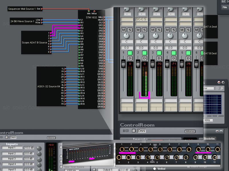

are you talking about channel 2 input? It makes a "peep" sound?
Well... hardware inputs are free (without any synth connections)
A16 ultra meter shows nothing
Just when I link Scope ADAT source with Mixer peep signal appears.
1.) Are you using ADAT or Z-Link? If ADAT, is the A16 clock master, or is SCOPE?
2.) Can you check all channels, to see what noise comes through on each?
1) Yes, ADAT optic cables (tried different) in ADAT sync mode (Master is Scope card)
2) Each channel except problem one is quiet and ok.
Please, look at the picture I've prepared.
Also I've attached the .mp3 with current peep sound from ADAT source.

Send audio into the other channels. See if you only get peeps on the even channels. Also, check the channel you do get through ok, and see the volume level of it, and whether it is 3-6db below what you expect.
Last, check the master clock frequency...is it 48kHz or 44.1kHz? Check if the peeps/noise only appears at one of those settings.
I have similar problems, only at 48kHz, which is why I ask.
Amazing, but I've just switched Sample Rate from 44.1 to 48 (peep still sounded) then to 96 and then back to 44.1... Peep sound has gone ))) even after reboot
