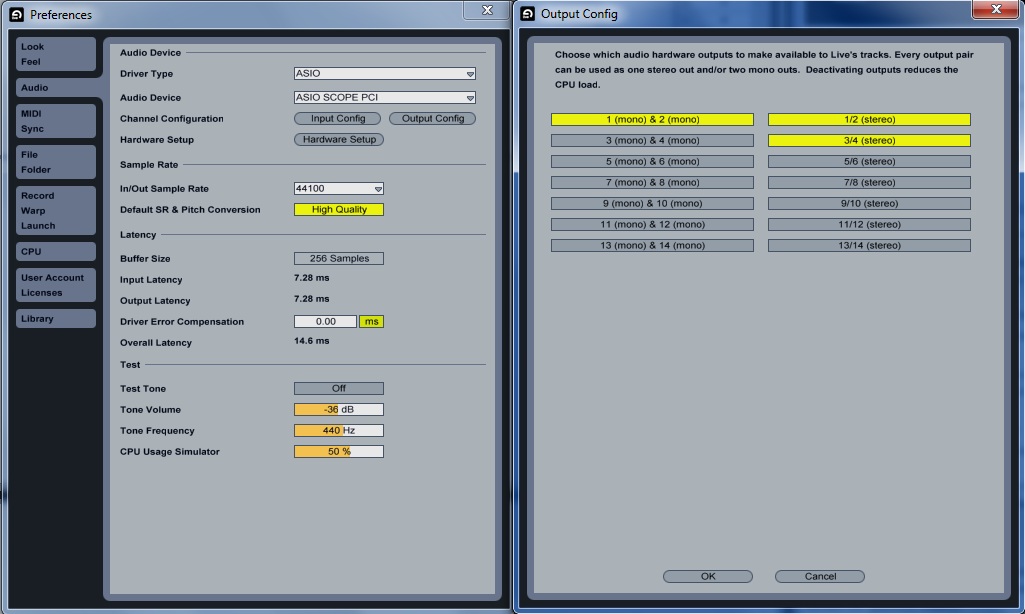

First off, Gary is right regarding the external outputs. look below...
From preferences you go to output config and enable your outputs by clicking them. Available outputs depends on how many outputs you have on the ASIO source module in your Scope project.

Of course, make sure SCOPE is running with a project that has all the ASIO and MIDI you want already loaded.
Changing the project will make ableton loose connections and require a re-start, so make sure you close ableton, open new project, then open ableton again.
