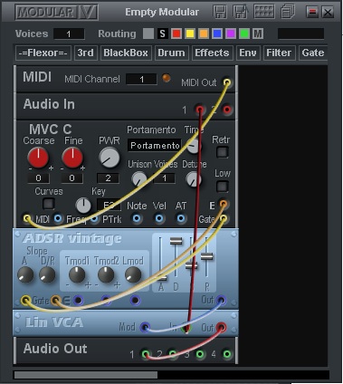

The more I play with my new MFB Kraftzwerg synth, the more I realize that I need additional EG/VCAs. It has three oscillators, but I can only use them for stacking since it only has one VCA. If I had a few more VCAs, I could create separate MIDI sequences in Live and send them to the Kraftzwerg on each oscillator (either as MIDI or as CV using Expert Sleepers Silent Way). So is there a software plugin in Scope or otherwise that simulates an EG/VCA? Right now, I can route the audio of an oscillator into Live and it plays constantly. I just need a way to shape that sound using my MIDI input as a gate. Maybe the Scope Modular has such a thing. I haven't done anything with audio input in Modular before. Thanks!

Sure, quite easy to achieve with Scope Modular.

If you only want a midi triggered EG/VCA for an incoming audio source its very easy to achieve.
You can ofcourse do a lot more between input and output, but this is the basic.

Thanks!! It works great! I've been reading the posts here regarding using Silent Way with the Scope Modular. I can't wait to see what type of hybrid modular I can make between the software and hardware. This is really fantastic!
