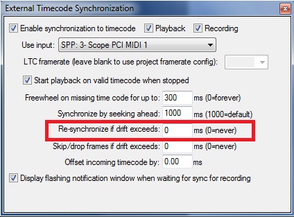

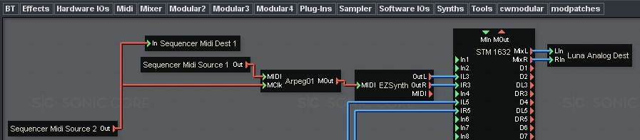

I have had this up and running in both reaper and ableton live so i guess its fine with cubase as well. Here's a screenshot of an example project setup:
Sequencer MIDI aource 2 is where the PTC sends its clock signal. This signal is routed to both Arpeg01 (Mclk) and the sequencers midi input (MIDI dest 1).
Reaper is then told to pickup its clock from MIDI dest 1, and let PTC control it:
Now, pressing space with the PTC window active fires it all up, with a "stabelish" clock.

In example, i just upped PTC tempo to 185bpm (Scope reports approx 205), which made reaper jump and skip until i changed some (obvious) configuration:
