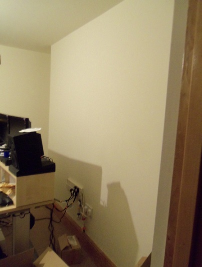

The wall is 2380mm wide approx. The surface is hard - plaster with emulsion-great to stick something on...
Pic from door.jpg (542.38 KiB) Viewed 2016 times
Here is a pic taken from the door.

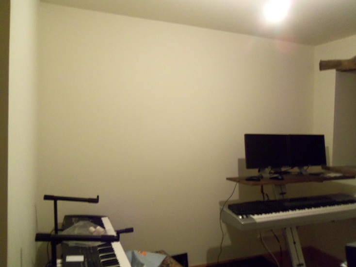

Here is the opposite wall where the speakers will hit.
Opposite wall to speakers.jpg (575.86 KiB) Viewed 2012 times

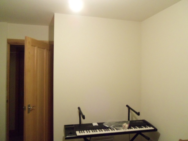

This is the window
Window pic.jpg (574.41 KiB) Viewed 2012 times
Opposite window
Inside the room will be an office desk 1400mm wide 800mm deep plus 2 x keyboard stands and two PC's. The desk has 2 x 4U Racks on top where the speakers stand on Auralex foam product. Speaker stands could be bought if you think this is not good enough....

Opposite window - I put this here as I could only load 3 attachments.... :)
Opposite window.jpg (549.54 KiB) Viewed 2012 times
