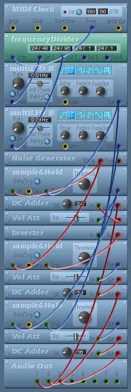

I put together this toggling sample+hold patch based on a diagram I got from the Doepfer site. The three audio outs are going to the three oscillators of my MFB Kraftzwerg via Expert Sleepers ES-3. My question is, how can I make this patch more efficient with less modules by using gates instead of triggers? I tried swapping the frequency divider for a clock divider and sending the gate signals into the S&H modules, but it doesn't work. Only the trigger input works. I turned off the button on the S&H modules (although the manual doesn't even mention what this button does) and still no difference. How can I modify this patch so that I can remove the LFOs? If you're wondering, I'm using the Vol Att and DC Adder modules to focus the frequencies to a specific area so I'm not sending completely random signals between 0 and 10 volts which doesn't sound too good.

Thanks!

- ES-3 Toggling S&H with Bass.JPG (49.84 KiB) Viewed 4228 times

Yes, I have Silent Way v1 & v2. In fact, I used it tonight to quantize the output of that Modular III patch to a scale before sending the signals to my Kraftzwerg oscillators. The LFO and Step LFO plugins are great for adding modulations to my setup. Today I connected 6' 3.5mm patch cables to my ADA8000 so I can have input from my hardware modular into the PC. I can't wait until Expert Sleepers comes out with an ES-3 input version! It's a lot of fun making hybrid patches with the software and hardware.
Looking at my Modular III patch in the above post, do you think it's possible to replicate that using only Silent Way? Maybe I'll try this weekend.

Getting back to my original question... How can I simplify this patch?
