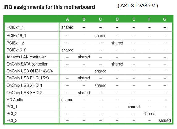

I have found this AM3+ Board but PCI1 2 & 3 are sharing with ?? E F G ?
ASUS F2A85-V.jpg (71.46 KiB) Viewed 4086 times

According to this, they dont share at all.. they have all dedicated.
no other device used thoes..
Higen
http://www.higen.org

so it is looking pretty god for my three pulsarIIs.
but again 270 euros.. for experimental PC buliding.
