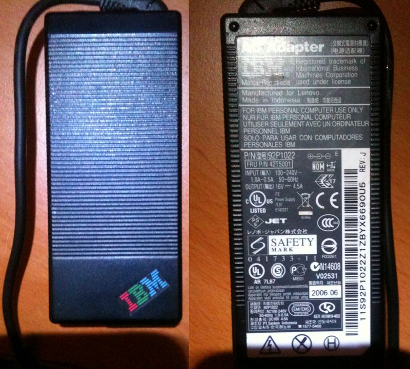

you can safely remove the fan if you use an original Thinkpad 16V PSU.
Those IBM PSUs were really high quality, it will auto-shut itself off if you switch off the A16, no need to unplug
It doesn't have (AC) leakage over the output DC, as many other PSUs show.
Point is that the internal regulation of the A16 probably hasn't got much to regulate, so it keeps cool.
Try it, there are tons of these PSUs on ebay for a few bucks...
But it has to be an original IBM, 'compatible' units will not work and may even fry the A16
(I've seen it myself with a supermarket switching PSU, the A16 became hot as hell, but survived...)

Re: A16 FAN
Sounds like good advice. What does the original one look like? I'm afraid I might get the wrong one and fry it! I see a lot of PSUs on ebay but all are cheap copies and they don't even say the brand name. I wonder what is the highest quality fan I could get?
Re: A16 FAN
that's the proper one - you may find a cheaper supplier, but it's worth the amount.

Re: A16 FAN

Could you post a photo of your psu?

here's the front and back of the 2nd one I bought, there are lot's of different part number for the same device
this one is from the Lenovo time obviously
you might as well use the 3.6 A version which came with the Thinkpad
but my memory betrayed me... sorry, for dissing, but airflow isn't that bad in the A16
it's not cool that the regulation is in the basement to heat the chips from below, but there's roughly an inch for airflow from left to right
iirc the on/off switch is on the top cover with rather short wiring, not sure if you can open it fully without cutting the wires
but probably enough to cut the wires of the fan
I wouldn't suggest to run the unit without a fan in a rackmount.
best option would be to put it on a large metal plate, as the heat spreaders are mounted to the bottom of the A16 case
actually you don't need to open it, if you mount a fan to the outside and let it blow into the A16's lower half.
(depends on where the unit sits)
