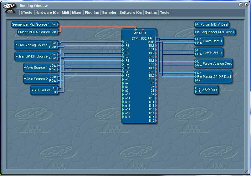

Thanks for replying. I cannot enter Cubase yet, error message screen problem.
But here is my routing window, its the default.

is XTC mode enabled?
do you have the Scope running before opening Cubase? there is an ASIO patch for v4, but it should only affect Cubase 4 and higher.
http://sonic-core.net/downloads/asiosco ... _patch.zip
even without the patch, you should be able to open Cubase with wave drivers.
strange, there doesn't seem to be an issue....

Garyb: I have XTC mode unticked. Should i enable it?
I always open Scope before Cubase, so yes its open.
