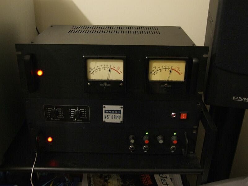

Trust your ears and trust these.....
- Meter.jpg (37.54 KiB) Viewed 2938 times

Yeah, that's what i am getting ready to use as these virtual thingys just don't seem to agree with my ears. Since my ears are pretty good, I mean I can look at a piano and hum the note, have someone play a four note cluster and I can select each note and it's order+ octave, I tend to trust them. Don't know if they nullify but I know they work.
I am going to use the Coleman my friend has and just use these virtual ones to let me know the sound turns to shit if it gets too close to the virtual red color..

I'm hearing ya. A while ago I had a job to level out backng tracks for a female vocal trio. Normalise doesn' work, limiting doesn't work. Digital peak meters don't work. All that is left is to sit there and ride the faders using ears and above analogue meters.dawman wrote:Yeah, that's what i am getting ready to use as these virtual thingys just don't seem to agree with my ears. ............

Well the Colemen worked great, I don't expect this virtual stuff to be accurate on summing if it can't be accurate on a single stereo source.
But I can say it is consistently off by 2db on solo and sum.
I believe these meters are gauged at digital noise occuring on 0db and then figured anything below it must be accurate.
Now that I know where they are gauged, and most seem to be the same I can pretty much run channels and master at -4db.
I like the sound of Scope so I don't want my mixers master FX having Limiting or Compression, but after the mixer (Post) I run it through the (Pre) BX Control for the mono sum/stereo width treats to the Analog Destination Module and this works really well on my 2000 watt 8" Cabs.
I can use all of the ITB Meters now from Weaper, Spubase and Scope now knowing I just need to change my concept of Gain a little.
