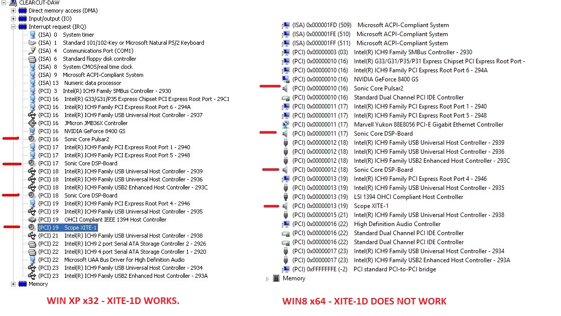

Heres the scenario with the IRQ's - look almost identical in XP and Win8 - also no obvious problems in the XITE-1D properties box.

Anything else I can try ?

yeah, disable the usb controller on irq 19 for starters.
that irq assignment isn't that good for the Scope cards, but there's nothing you can do about it. it's a combination of motherboard design and windows assignments. the video controller with the Scope card is bad, too. unless there's another PCI slot, you can't do much about it since you can't disable it.
the usb controller on 16 should be disabled, too. and 18 is all usb controllers. they must die.
usb is a big blabbermouth always gabbing about, "is some thing connected?...is some thing connected?...is some thing connected?..." and "igot something! i got something! i got something...." the Scope card cannot wait when it's turn arrives to speak to the cpu, because an audio stream is a realtime thing. the usb controller is a big c+++ block.
get another computer. run two.

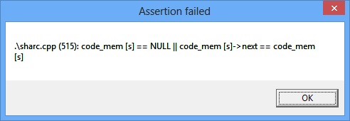

if the pc hibernates, you will get an error message. your pc should NEVER hibernate. i still suspect a power setting, UNTIL you tell me that the XP partiotion has stopped working. post a screenshot of your error messages. if the software is not connecting to the XITE, it's probably a hardware issue with the cable being most likely. if it's only windows 8 that has a problem and your computer is allowed to hibernate, then that is the problem.

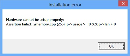

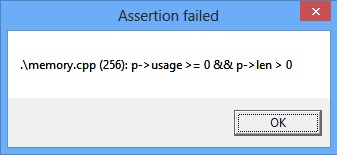

Here are the error messages in sequence :
Error 1
Error 1
Makes no difference here if I choose 'Yes' or 'No'
Error 2
Error 2
Error 3
Error 3
Posts: 5052
Re: Windows 8 issue.
Error 4
Error 4
Error 5
Error 5
Error 6
Error 6
I agree its like a power issue. For example, if I turn XITE off / on whilst windows is running I would get the last error message 6 straight up - and this is what happens if I try to run the old XITE-1D 32 bit from the XP partition compatibility mode ( in Windows 8 ).
The only difference is I get the Error 6 message straight up, without the other first five.
But just starting XITE normally (powered on before the PC as per normal) in Win8 I get all 6 messages in above sequence.

did you install the additional files needed for the XITE-1D?
they should be on the cd that has the keyfile, but they're also on the server under hotfix for the XITE-1D:
ftp://sonic-core.net/software/scope_5.1_x32/

DOH ! DOH ! DOH !
You've done it again garyb. Problem fixed.
I also didn't read my own guide where you gave the cset.ini hack, so I did that as well :
http://www.hitfoundry.com/issue_09/xit_mast.htm
But i need to add that hotfix link to the article, and now say it works for Windoze 8
I was so focused on this being a Windows 8 difference, I forgot about the XITE-1D being different - from normal XITE-1.

great. i knew what the problem was once i saw the screenshots.
