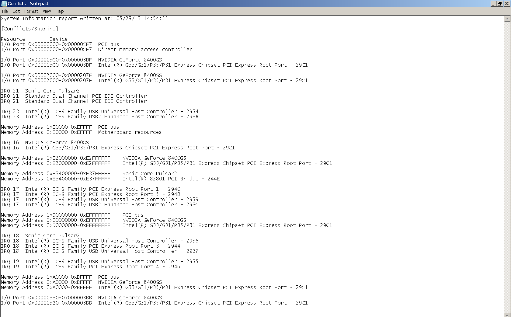

I've started using Windows 7 and recently tested it with latency monitor and have notice a few problems.
I've monitored it also with windows Performance monitor, which is really good. It shows me a lot of IRQ activity when I use my USB mouse and USB keyboard and I think it may be to do with IRQ conflicts.
Also one of the Scope cards is SHARING AN irq with PCI IDE Controller, which holds my main O/S hard drive with samples.
Are the IRQ conflicts the main problem here? Would putting every USB device through a single USB port help? I wanted to add wifi so that I could use the Ipad as a controller. Also my Axiom USB Midi keyboard controller seems to cause some instability. Again is that the IRQ conflict?
- Conflicts.png (88.14 KiB) Viewed 2373 times

the PCI and PCI express ports are probably fine. you do need to disable USB controllers 2936 and 2937.
that will leave you with 3 or 4 usb controllers and 2 enhanced usb controllers which is plenty.

you are disabling controllers, not the ports themselves. a controller may handle more than one port.
