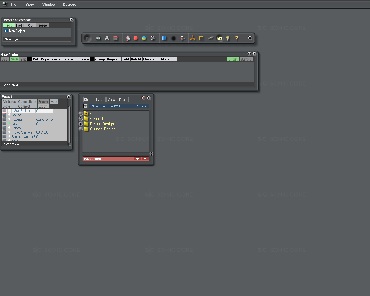

Re: SDK as music creation software?
Ankyu. Ready to put everything I use into 2 x BCM Shells.
One for Sources, the other for Destinations, and everything can re recalled
via Screensets.
That is my first goal.....
2nd goal...........The World.
SDK 5.1.png (98.05 KiB) Viewed 2355 times
