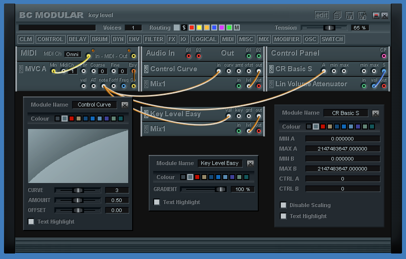

Maybe I'm misunderstanding the question but could you not just use the Note output from an MVC?
You could pass it through a control ranger to adjust Min, Max and Curve for connecting to a Mix Module or convert it to sync and feed a VCA.

Thanks, Sharc !
Is the Async to sync module the midi note to modulation signal module ?
You give me 2 simple solutions ! Merci beaucoup ! And it works perfectly ! It gonna be very useful.

JoPo wrote:Is the Async to sync module the midi note to modulation signal module ?
In this case, yes I suppose you could look at it that way. Like the name suggests it basically takes an async control signal and converts it to a sync control signal.
You could instead connect the note output directly to the VCA 'vol' input but that can get messy if you change your mind with the connections. The reason for this is that it would do the async to sync conversion in the background and in modular this can cause problems. My recommendation would be to avoid this and use the async to sync module when a conversion's needed.
