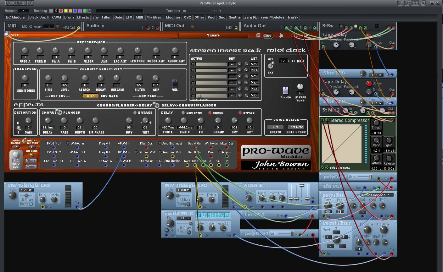

Hi, I have a patch i'm working on that keeps crashing whenever I try to move the modules around, so i was wondering if someone could load this up and let me know how it works. I need to know if it's the patch or my system. I suspect it might be those Tape Delay modules. You will need JB's ProWave (modular) obviously, Xite-1 and ModIV

bluescreen here.
It is the tape delay causing issues on the xite.

Re: ProWave Patch
Cool Yayajohn.
I think you need the current drivers that Herr Schmidt sent us to use a pair of Tape Delays with such a beast. I have no access to my rig just yet, but using 2 x Tape Delays is definately the problem if one gets a blud screen.

Re: ProWave Patch
Ok yeah I figured. Those blasted things, I have a love/hate relationship with them. (I hate that I love them so much lol)
I have been using them as an Aux effect for quite a while but they don't seem to like this config as this is the second time i've built this patch from scratch. I could probably just send the audio out to the Aux effect with the Tape Delay and that would pretty much do the same thing.

Re: ProWave Patch
Ok, I got rid of the Tape Delay and added some pan. Seems pretty stable now. Try it out if you dare. I'm a hack at this so if something doesn't make sense to you then by all means speak up, any hints/suggestions would be greatly appr.

Re: ProWave Patch
you got bcmodular try using the clm and creating a delay using the mod delay modules i made a bbd the same way

Re: ProWave Patch
can i also ask you why you went poly out to the 2 filter modules making them mono fx
and why the vca are before the filters and no vca after the filters
i would of done it osc a and b to the filter module then to the vca then to poly out modules then to the compressor

Re: ProWave Patch
ok im building a stereo tape delay module in the clm for you to try it fits on one dsp nicely
and i have built in pingpong feedbacks for the left and right channels also
it has speed for the modulation delay time regen left and right and cross delay regen left and right and

Re: ProWave Patch
You can open the RD modular shell, build the poly filter in that, and load it into the filter slot.
