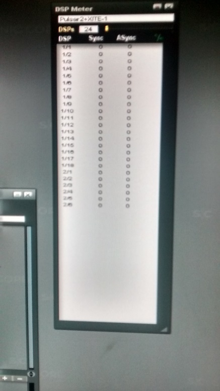

I reinstalled my PC to Windows 8.1 32bit. I ran 64 windows 8 before this and encountered the same issue.
The Scope XITE installation shows my Pulsar card.
http://forums.planetz.com/viewtopic.php?f=19&t=32932
Now with this fresh installation (new harddrive, differnt windows 8.1 32bit install software) I see the same thing (screenshot attached).
Would this be the XITE driver somehow being confused with Windows 8.1 internals and being aware of the Pulsar card ? There are two scope cards in the machine as well, but as you can see they do not show up.

- IMG_20140824_134103393_HDR.jpg (128.19 KiB) Viewed 1798 times

Installing Scope PCI has no effect. The driver install sees the Pulsar Card. But the software does not. I can't select the card when importing key-file.
I think, somehow, the Pulsar card ends up in the device manager as "Scope XITE". If I look under the Sound Video Gamecontroler section of section of the device manager I see:
Scope XITE
Scope XITE-1
Sonic Core Scope
Sonic Core Scope
Those last two are obviously my Scope + Scope SRB card. So Scope XITE must be the Pulsar.

That worked somewhat...
I deleted the Scope XITE device. Rescan for hardware changes => Same problem.
Then deleted the device and checked 'delete driver sofware'. Rescan for hardware changes and immediatly the Scope Pulsar appeared. However one of the scope cards disappeared and showed up as "unkown multimedia device" or something. I reinstalled that driver and it seems to be working.
Can't get ASIO working yet on the Pulsar. Perhaps because STDM cables are still disconnected, but I doubt that. Will investigate further.
The XITE install now works and sees no Pulsar.
I checked the logs of the Scope Pulsar device and it showed that the ScopeXite driver was being used at first, then it used the Scope driver.
Of course its still a mystery why the ScopeXite installation software attaches a driver to the Pulsar card......
