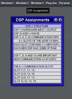

Dsp 10 ?? I thought it's SC who made dsp 2 for asio ! I Never heard dsp 1 about asio... The dsp 1 is for hardware i/o, isn't it ??
The bible :
DSP assignment.JPG (30.67 KiB) Viewed 5380 times

i don't want to confuse you. I put Vdat in dsp 2.
I do tests with different positioning of the asio and i have reached the conclusion that it allows more channels in 10.
Perhaps it was something else...
My (practical) understanding of the dsp structure of the xite-1 is as follows:
1-6 old sharcs. VDAT works only on dsp 2.
7-18 new sharcs. That's it.
7-11 have better (probably) communication with asio.
I only use the new dsps.
Connections inside a dsp doesn't consume any communication. Connections between dsps cost communication.
