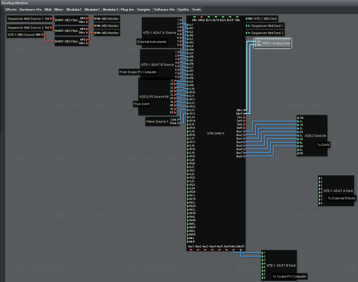

I'm looking for some suggestions of a neat and tidy way to send audio out from my project window to a hardware effects unit and back. Doesn't have to be the STM2448 either.
Also is there any way to attach these labels to the IO modules. I used the notepad feature for these but they are their own entities and I seem to move stuff around quite a bit.
btw the input return would be via the Xite-1 Analog source module.(not depicted)

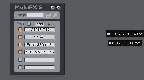

Check under 'Tools' menu - theres 'external effect S' there isnt there ? Specify whether its an ADAT, Analog or SPDIF port.

just send signals going out of the computer out the ADAT dest and signals coming back into the computer through the ADAT source. of course you do need an AD/DA, but you can use any of the i/o in this way. nothing extra is required.

There are two worth checking...as Dante mention there's the external effect S device, and there's also an external mastering device, which provides meters and delay compensation for dry/wet mixing, too.

sure. the routing is built into those devices.
Re: External effects loop
Ok cool. I think those 2 modules are going to work just great. Took me a little bit to understand the routing but I think i've got it.
I will use the External Master Effect. Pipe the Aux 5&6 to the input and pipe the output to track 24 on the mixer. Internally i've got it routed out to ADAT A Dest and back in through the Analog Source.

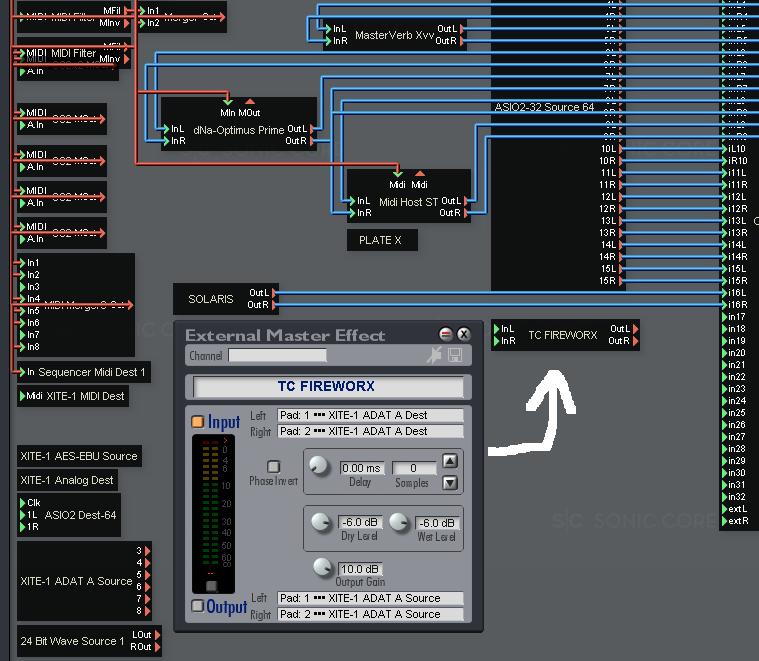

External Master Effect modules are awesome, and I recently bought 2k worth of
hardware FX for our PA and myself.
I found that having ADAT connections brought more precision to the signals so
have opted to use a pair of 350.00 USD TC Fireworx.
Excellent Modulation and Distortion FX along with beautiful Reverbs and a unique
Reverse Delay.
FWIW I now send my mix from RoyT's 8 x 8 via ADAT to a Behringer X32 rack that
sends signals to the QSC KW153;s and MW 181 Subs.
Scope XITE-1 sounds incredibly powerful as a live keyboard mixer.
I still use STW Plate X on Pianos/Rhodes/Wurlitzer/B3 stuff, Fraxx77's Master Reverb
as a Gated Reverb for all Horn Sections.
And of course dNa Prime Optimus has the sounds I require for Delay+Modulation.
It's delay tails trail off just like an old Lexicon PCM42 or Prime Time Model 93.
But if you get bored and want an FX unit with ADAT to keep down the -6 db
insertion loss
of analog gear, check one out on ebay.
Run this into an AUX CHannel or Bus, or just use it to do single tracks taking advantage
of the multitude of great FX it offers.
I use one on vocals that has a Doubler on slot one, followed by reverb or delay,
or filter, distortion or a combination of a few until the DSP chips show you are
out of juice.
I think You got the point,
But here is my Project with fl studio
- image.jpg (127.28 KiB) Viewed 3609 times

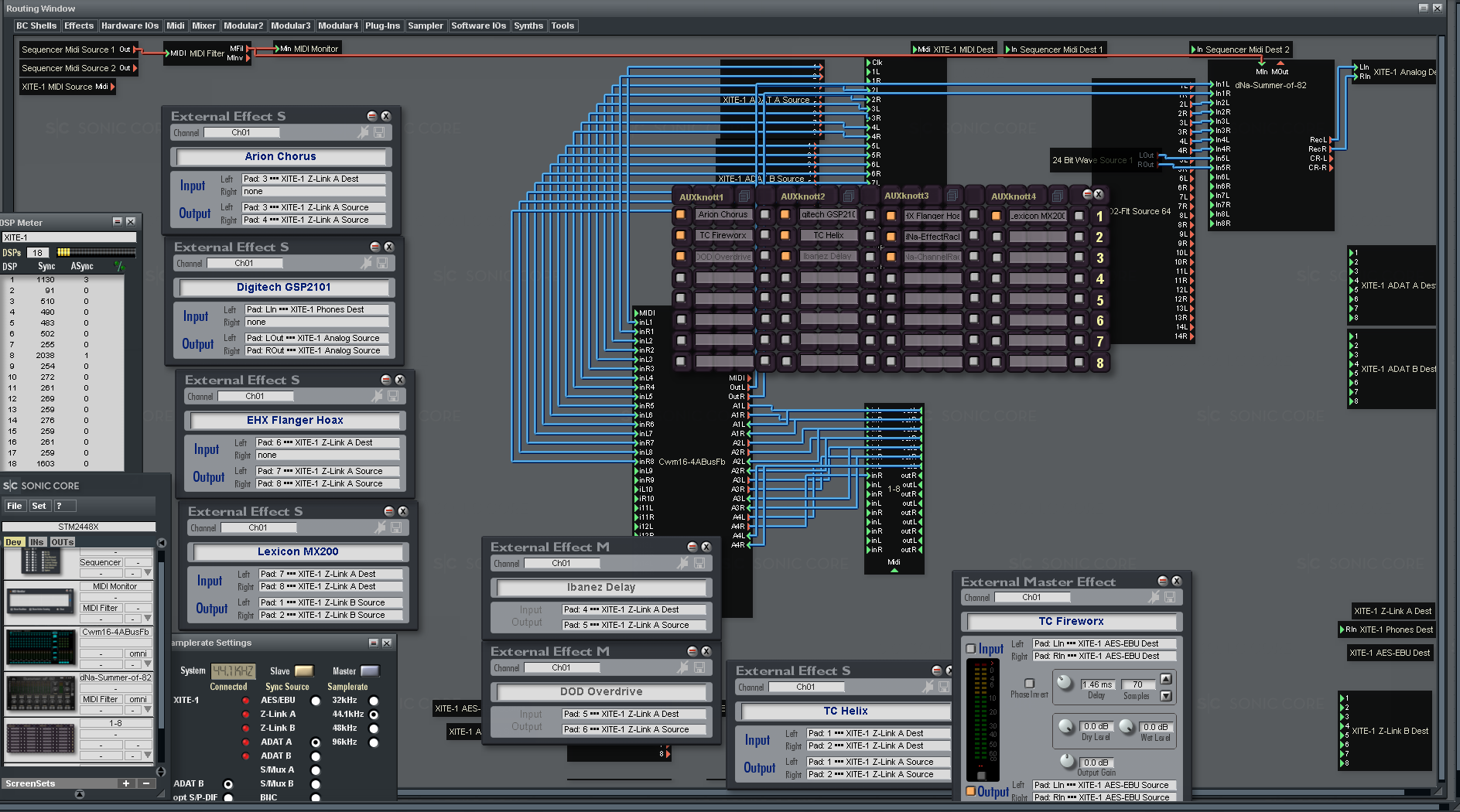

Well as you can see I've accumulated a few more external effects since my original post. I have these all hooked up through an A16Ultra to a Behringer Ultrapatch Pro. After frying my brain trying to figure out the best flexibility routing with matrixes/mixers/aux sends and such I just discovered that I can save my external effects modules in the stereo/mono effects folder and just use them as an insert and when you load them up it makes the connection. WOW! Can't believe I missed that one until now.
Sooo many awesome features to this platform!
- External Effects.PNG (362.66 KiB) Viewed 3104 times
