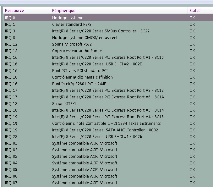

Re: Discrete crackles
Euuu...h... Just a minute, please....
Here are irqs, apparently the Xite is alone on 18. Sorry, it's in french -> périphérique = devices ; ressource = ressource...... Ok = ok !
On my ancient pc, the xite shared the graphic card + something else like usb, don't remember well but there was no noise and hyperthreading was on. Yes, I know, it doesn't mean nothing...
If I understood correctly, my cpu doesn't have any hyperthreading feature but turbo, it seems yes :
http://ark.intel.com/products/80816/Int ... o-3_70-GHz
Turbo is suppose to start only when needed and I don't think I've already pushed the pc ressources as hard.. Why would this be a problem ? If I understand well, when turbo is active, instead of running at 3Ghz, the cpu runs at 3.7Ghz...
But I must say that my computer features knowledge is quite limited !
Any idea ?

Strange ! By looking at irqs I notice that "contrôleur audio haute definition" (High Definition Audio Controller) is there and I deactivated it in the bios... I go to check that...
- Posts: 2306
- Joined: Wed Jun 05, 2002 4:00 pm
- Location: VRRAAaaooOôOooommmh
The high definition audio controller IS unable in the bios ! How is it possible to have it in the irqs ??
I can see it in the device manager too !
What is one suppose to do to remove it ? Desoldering its components on the mobo ?

- Posts: 1638
If you have an HDMI video connector or ADAT output on the board, that may show up as a separate Audio device.
Disable in Windows Device Manager (Right-Click on the device in the list, and you'll find the drop-down menu to disable in there)
- Posts: 2306
Jksuperstar'> you must be right. And only the hdmi audio is not deactivable and I need the video outputs.
I disabled it in the device manager but the irq 16 remains to it... Anyway, it won't ask any interuption anymore, right ?
Thanks, JK !
Thanks, JK !
