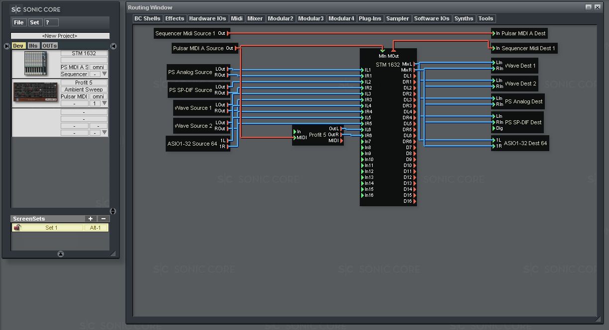

My setup is simple my master keyboard is plugged in to the BCR's midi in port
The BCR's output midi cable is going into the Pulsar midi in
and both are connected via usb as well
If I disconnect the BCR and just have the keyboard , I can play the profit
In the project window pulsar midi in is going to the Profit 5 (see attached jpg)
I use either Studio one or Reaper as my DAW, (but scopes Dll's always crash)
and although both the BCR and my keyboard work with no problem in studio one and reaper
Scope will not respond even when the sequencer source module outputs to the profit
I'm finding Scope pretty frustrating....fantastic sound but a pain to use

Well.. If midi channels are set correctly, I don't why it wouldn't work.
And if you put the "sequencer midi source 1" module at the profit midi input in Scope, then play notes on a "pci midi 1" track in your sequencer, you don't get any profit sound ?

Gary: Studio one and Reaper refuse to load the Scope dll's , If I rescan vst's in studio one or reaper (both x86)
the d'lls won't load ( also I don't have a Profit 5, Minimax, pro-oddesy dll's in the scope pci folder)
''And if you put the "sequencer midi source 1" module at the profit midi input in Scope, then play notes on a "pci midi 1" track in your sequencer, you don't get any profit sound ?''
yes, thats right, but i can play fine in my daw?
bloody strange maybe I should reinstall everything?
