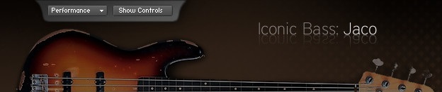

This is what I would use to get that sound :
Iconic
Iconic

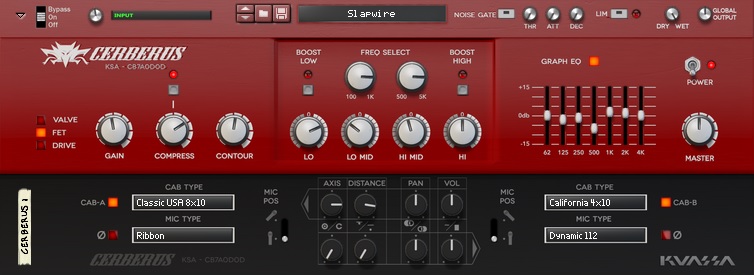

PLUS (to boost the growl) :
cerebus
cerebus
Posts: 2306

-> Dante : yes ! That's almost it. In the mp3 I posted, the sound is a bit more dark. I know the orange tree one, good one ; but I don't know Cerberus... Is that a reason plugin ? If it is, I can't use it : they don't release anything in vst format ! I really think it's stupid !
Ah ! No I've found it in vst's ! Thanks a lot ! I'm going to check that... :)

JoPo wrote:> Dante : yes ! That's almost it. In the mp3 I posted, the sound is a bit more dark. I know the orange tree one, good one ; but I don't know Cerberus... Is that a reason plugin ? If it is, I can't use it : they don't release anything in vst format ! I really think it's stupid ! Ah ! No I've found it in vst's ! Thanks a lot ! I'm going to check that... :)
Yeah Kuassa do VST ! Some dude on ReasonTalk just said the Tube Preamp on Cerebus is da bomb - gonna try that out next, coz I had it just set on FET. Reason's Line 6 license runs out next version (Reason 9), so Reason users are evenly devided between Softube and Kuassa for guitar amping. To me Kuassa wins and is on par with the Softube amps on Scope - however I cant use the Scope ones any more since they dont run at 96Khz.
So Kuassa is top of the pack. This fat number for $35 buckaroonees is a steal... http://www.kuassa.com/products/cerberus ... ifikation/
