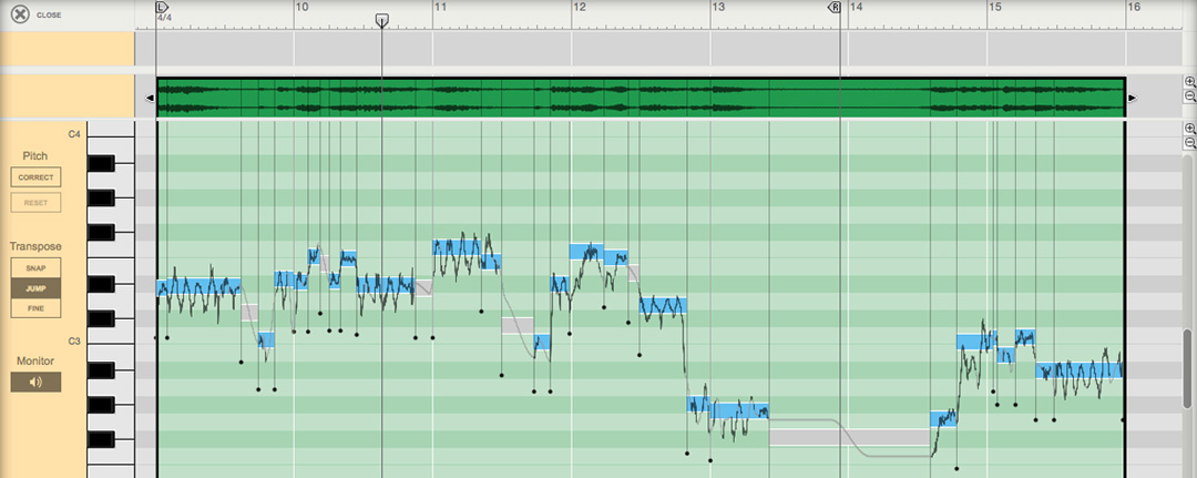

I wont be upgrading Cubase past Cubase 8.0. I only use it to dump stuff out and now that Reason 9 will have a Mellodyne style pitch edit that will be the final deathknell for me putting $$ to Steinbug.
Reason 9 pitch edit
Reason 9 pitch edit
