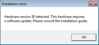

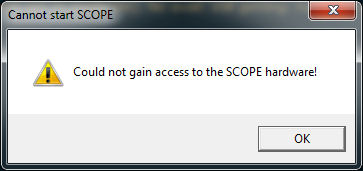

At the moment, we have a strong heatwave here at my place (around 35 C every day). My Pc was dying every 20min ( located in a A/C room). So I decided to buy a new cooler, which helped a lot. The temperatures at the CPU are around 30 C and also system/graphic have very little heat). But one problem remains: the XITE-1 have various problems: computer freezes, when Scope starts, or after some time giving error messages like SDRAM errors, PCI connection lost, copyright protection failure etc. Also: hardware version 3.0 detected, wrong software version.
Any ideas, how to resolve this?

Thanks, I'll try that (was set to moderate). No avail: still getting:
and
These are the same errors, as if the Xite was switched off.
